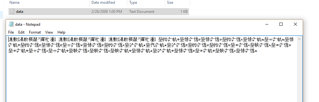

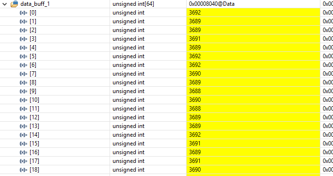

I've been (slowly) working on a data logger for a project. The idea is to read in data from the onboard ADC, convert to comma separated values, and then write these to a file on an SD card. All of this is working until a signal is attached to the ADC. This can be an arbitrary sinusoid, attached to ground directly, or attached to ground through a pull down resistor and the issue occurs.
Running it without anything attached produces the following: "Power on, begin new logging.  85,9,0,0,0,0,12,..." and so on -- basically sitting at 0 with some slight noise. Running anything on the input produces reads correctly (as far as I can tell), converts to CSV correctly, but then writes out "潐敷⁲湯‬敢楧敮⁷潬杧湩⹧ 㜳〰㌬㠶ⰴ..." Interestingly, the initial "Power on" message does write out correctly (if I pause and remove the SD card), but is overwritten by the garbage data. Additionally, for approximately the same amount of time running, the garbage data files are orders of magnitude larger (1KB vs ~100KB).
