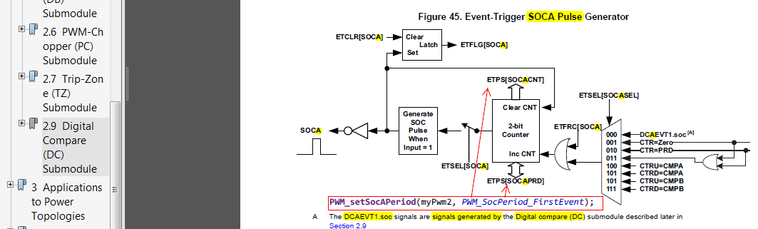

c2000 f28027f -Use Digital Compare (DC) submodule to generate a SOC pulse
I'm trying create a program that generate a SOC pulse to trigger an ADC conversion. I want to use the Digital Compare submodule to generate the SOC pulse, for this i'm using the comparator with the internal DAC to produce the DC event.
I don't understand that is wrong in my code, because the conversion not is generated, in other words the SOC pulse don't is created.

	PWM_enableSocAPulse(myPwm2);								// (ET&I) ETSEL[SOCAEN], Habilita/permite pulsos SocA.
	PWM_setSocAPulseSrc(myPwm2,PWM_SocPulseSrc_DcEvt); 			// (ET&I) ETSEL[SOCASEL], Fonte que gera o pulso SocA (Enable DCAEVT1.soc event), sinal gerado pelo (DC) -Digital Compare
	PWM_setSocAPeriod(myPwm2, PWM_SocPeriod_FirstEvent);		// (ET&I) ETPS[SOCAPRD], Gerar o pulso na 1ª ocurrencia da fonte do evento

If possible can someone confirm me if the code lines 32 to 40 is correct to configure the Digital Compare for generate a pulse SOCA?

    Can you tell that the Comp and ADC registers are getting configured? Have you called CLK_enableCompClock() and CLK_enableAdcClock() somewhere in your code?
    Whitney
    You made a good analysis and fast, I did not start the clock comparator because he thought it was only necessary if the intended use synchronization comparator output. My problem is solved!

    The corrected code is as follows:
    void Config_Comp1(void)
    	//GPIO_setMode(myGpio, GPIO_Number_1, GPIO_1_Mode_COMP1OUT);	//Para fazer sair no pino o estado da saida do comparador
    	CLK_enableCompClock(myClk, CLK_CompNumber_1);				// PCLKCR3[], Enable clock to the Comparator1 block
        //ADC_enableBandGap(myAdc);									// 1ºpasso (da inicialização) Initialized in de ADC configuration.
        COMP_enable(myComp1);										// COMPCTL[COMPDACE], 2ºpasso (da inicialização) Power up Comparator 1 locally
        COMP_enableDac(myComp1);									// COMPCTL[COMPSOURCE], Entrada inversora do comparador conectada ao DAC interno
        COMP_selectDacSrc(myComp1, COMP_DacSrc_DacValue);			// DACCTL[DACSOURCE], Select the souce to control the DAC ("COMP_DacSrc_RampGenerator" ou "COMP_DacSrc_DacValue").
        COMP_setDacValue(myComp1, 512);								// DACVAL[], Set DAC output to midpoint
