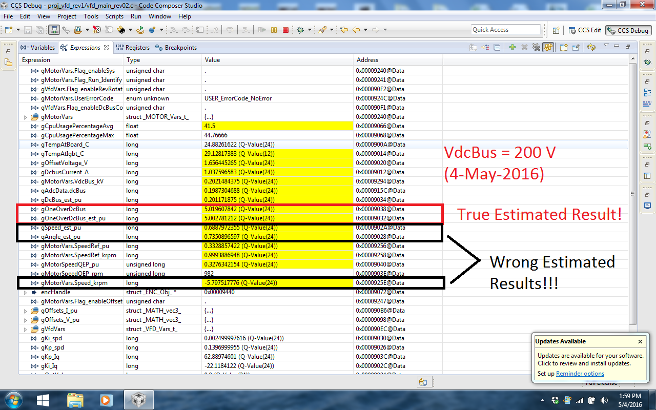

Although I checked the result of measurement of the motor voltage and motor current, and debugged them by PWMDAC. the result is good, as following:
a) Iab_fb_pu.value[0] and Iab_fb_pu.value[1]:
b) Vab_fb_pu.value[0] and Vab_fb_pu.value[1]:

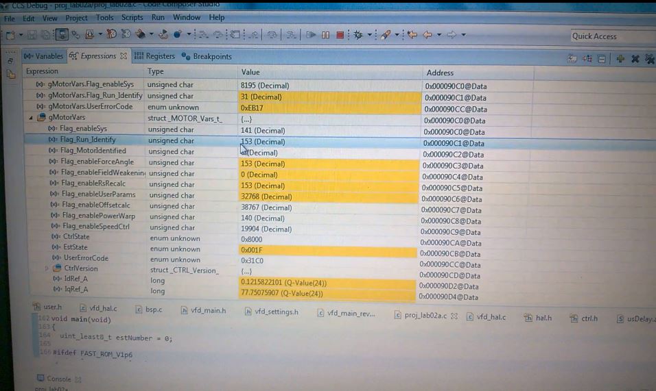

And this is the screen shot of debugging window when I run the motor to check Estimator's operation:
I don't know the reason why the Estimator did not work well. Please give me an advice.

  • your I_pu [2] is wildly incorrect.
    are you using your own HW? with 2 or 3 currents being measured?
    I'd also check your voltage circuits and make sure the settings and pole are in user.h correctly
  • Dear Chris,
    The result of I_pu.value[2] that you saw don't have any value, because I only used two sensors for measuring current, and the result of I_alpha & I_beta is still good with two current channels as I posted above.
    For the voltage circuit, I also checked the results which is read from ADC and put them out to PWMDAC to observe and this is the signal of V_alpha & V_beta (after removing the offset). I think there is no abnormal thing here.
    Finally, below is my setting in user.h for current and voltage channels, beside I also attach the Motorware_selecting_user_variables.xlsx so that you can verify my settings:

  • I don't think this is an estimator use problem.  This lab works with other HW we have.
    I'm most suspicious of this being a HW issue.
    but it could be something missing in SW (not as likely) or maybe your motor parameters.
    I see you are using proj_lab02. Are you running motor ID?

    Today I modified the memory map in F28054F.cmd file as your suggestion:
    PAGE 1 :   /* Data Memory */
               /* Memory (RAM/FLASH/OTP) blocks can be moved to PAGE0 for program allocation */
               /* Registers remain on PAGE1                                                  */
       BOOT_RSVD		: origin = 0x000000, length = 0x000050		/* Part of M0, BOOT rom will use this for stack */
       RAMM0			: origin = 0x000050, length = 0x0003B0		/* on-chip RAM block M0 */
       RAMM1			: origin = 0x000400, length = 0x000400		/* on-chip RAM block M1 */
    /* RAML0			: origin = 0x008000, length = 0x000800		/* DO NOT USE THIS L0 RAM to avoid conflicts between user's memory and FASH/SPIN library	*/
    /*   RAML3			: origin = 0x009000, length = 0x001000		/* on-chip RAM block L3 */
       RAML3			: origin = 0x009000, length = 0x000E00		/* on-chip RAM block L3 */
       RAML3_RSVD		: origin = 0x009E00, length = 0x000200		/* reserve for allocating EST module */
       FLASHB			: origin = 0x3F6000, length = 0x001000		/* on-chip FLASH */
    I also adjusted the address to allocate for EST as following:
    #define USER_EST_HANDLE_ADDRESS     0x9E40		//(0x8000)
    #define USER_EST_HANDLE_SIZE		(0x200)
    After I recompiled and load the program to the DSP, and run the new program with real-time debug and I got the result on the first section:
    As the above screen shot, the estimator returned the true result for gOneOverDcBus_est_pu and gDcBus_est_pu, but the estimated speed (gSpeed_est_pu and gMotorVars.Speed_krpm), the estimated angle (gAngle_est_pu) is still wrong! I validated these estimated results with the values that I get from the sensors, such as: Encoder, Volt-meter, Amper-meter).
    The next, I exited to the above session and reloaded the program to the DSP, and ran again the program on chip. This time, I got an other result:
    You can see that, at this session, the estimator returned the wrong value for gOneOverDcBus_est_pu, but the estimated value for speed seems to be acceptable, although it's different to the speed which is get from Encoder (gMotorSpeedQEP_pu and gMotorSpeedQEP_rpm).
    After that I repeat the above process, and each time I got the same result as the 2nd time.
    I don't know why the Estimator did not work well? Although I checked the hardware conditions for using Estimator and verify that it 's no problem.
    a) These are two signals of phase voltage (on the motor terminals)
    b) These are two signals of motor currents in (alpha,beta) axis:
    Finally, I'm using the compiler version: TI v6.4.9 and CCS version 6.0.1.00040
    Whether I need to configure the compiler or/and linker to use FAST Estimator correctly or not?
    Thanks for replying as soon as possible,

    (4) Running the motor Identification and check if the estimated motor parameters are reasonable.
    The result is I got the video-clip at following link: www.dropbox.com/.../WP_20160513_12_11_33_Pro.mp4
    I observed that my motor ID was not successful, and the process of identification did not stop, the parameters on the debug window as the video-clip.
    I want to refer your experience that:
    a) With the above current and voltage signals, whether they effect to the motor ID or not?
    b) Normally, how long does it take in a process of Motor ID?
    Thank you!
  • Hi Tran,
    The current and voltage waveforms are acceptable for motor ID.
    What's the setting value of USER_IQ_FULL_SCALE_VOLTAGE_V ?
    In the end of your test video clip, The whole values of MotorVars are strange as below capture. I'm not sure why your debug shows the strange values. What's compiler version you are using? Can you attach .map file and user.h file?
