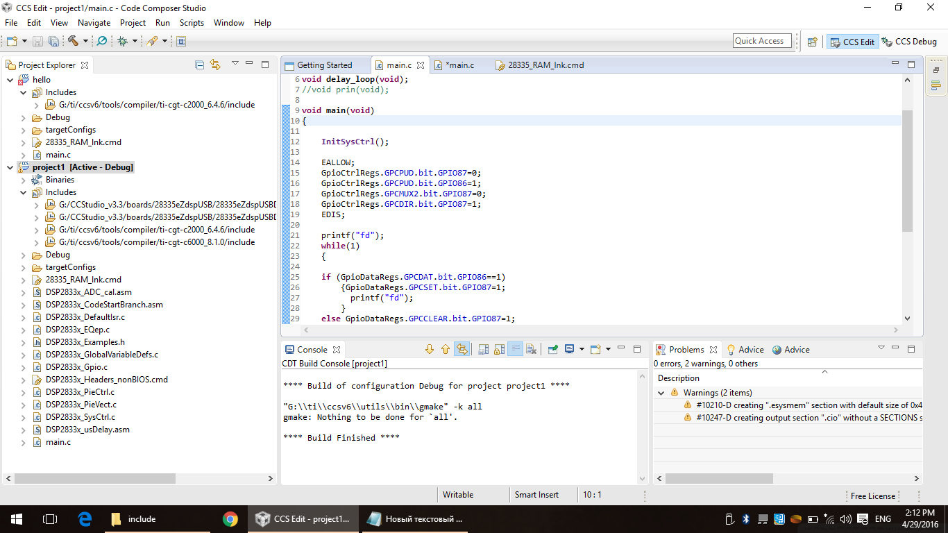

error #10099-D #10010: program will not fit into available memory f28335
Other Parts Discussed in Thread: TMS320F28335
i'm working with F28335 and CCS v6.1. and i have problem with showing message on my screen. I can not use puts() or printf()
there is my code and screen.
**** Build of configuration Debug for project project1 ****
'Building target: project1.out'
'Invoking: C2000 Linker'
"G:/ti/ccsv6/tools/compiler/ti-cgt-c2000_6.4.6/bin/cl2000" -v28 -ml -mt --float_support=fpu32 -O4 --opt_for_speed=5 --preinclude="G:/ti/ccsv6/tools/compiler/ti-cgt-c6000_8.1.0/include/stdio.h" -g --diag_warning=225 --display_error_number --diag_wrap=off -z -m"project1.map" --stack_size=0x400 --warn_sections -i"G:/ti/ccsv6/tools/compiler/ti-cgt-c2000_6.4.6/lib" -i"G:/ti/ccsv6/tools/compiler/ti-cgt-c2000_6.4.6/include" --reread_libs --display_error_number --diag_wrap=off --xml_link_info="project1_linkInfo.xml" --rom_model -o "project1.out" "./DSP2833x_ADC_cal.obj" "./DSP2833x_CodeStartBranch.obj" "./DSP2833x_DefaultIsr.obj" "./DSP2833x_EQep.obj" "./DSP2833x_GlobalVariableDefs.obj" "./DSP2833x_Gpio.obj" "./DSP2833x_PieCtrl.obj" "./DSP2833x_PieVect.obj" "./DSP2833x_SysCtrl.obj" "./DSP2833x_usDelay.obj" "./main.obj" "../28335_RAM_lnk.cmd" "../DSP2833x_Headers_nonBIOS.cmd" -l"libc.a"
<Linking>
warning #10247-D: creating output section ".cio" without a SECTIONS specification
warning #10210-D: creating ".esysmem" section with default size of 0x400; use the -heap option to change the default size
"../28335_RAM_lnk.cmd", line 130: error #10099-D: program will not fit into available memory. run placement with alignment/blocking fails for section ".stack" size 0x400 page 1. Available memory ranges:
>> Compilation failure
RAMM1 size: 0x400 unused: 0x0 max hole: 0x0
error #10010: errors encountered during linking; "project1.out" not built
gmake: *** [project1.out] Error 1
gmake: Target `all' not remade because of errors.
**** Build Finished ****

    you cmd help me, but problem is still the same. i can not see any message on my screen when press button
    there are my screens of mistakes and warnings

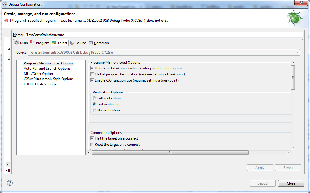

  • Also, did you enable CIO in your Debug Configuration:
    Stephen

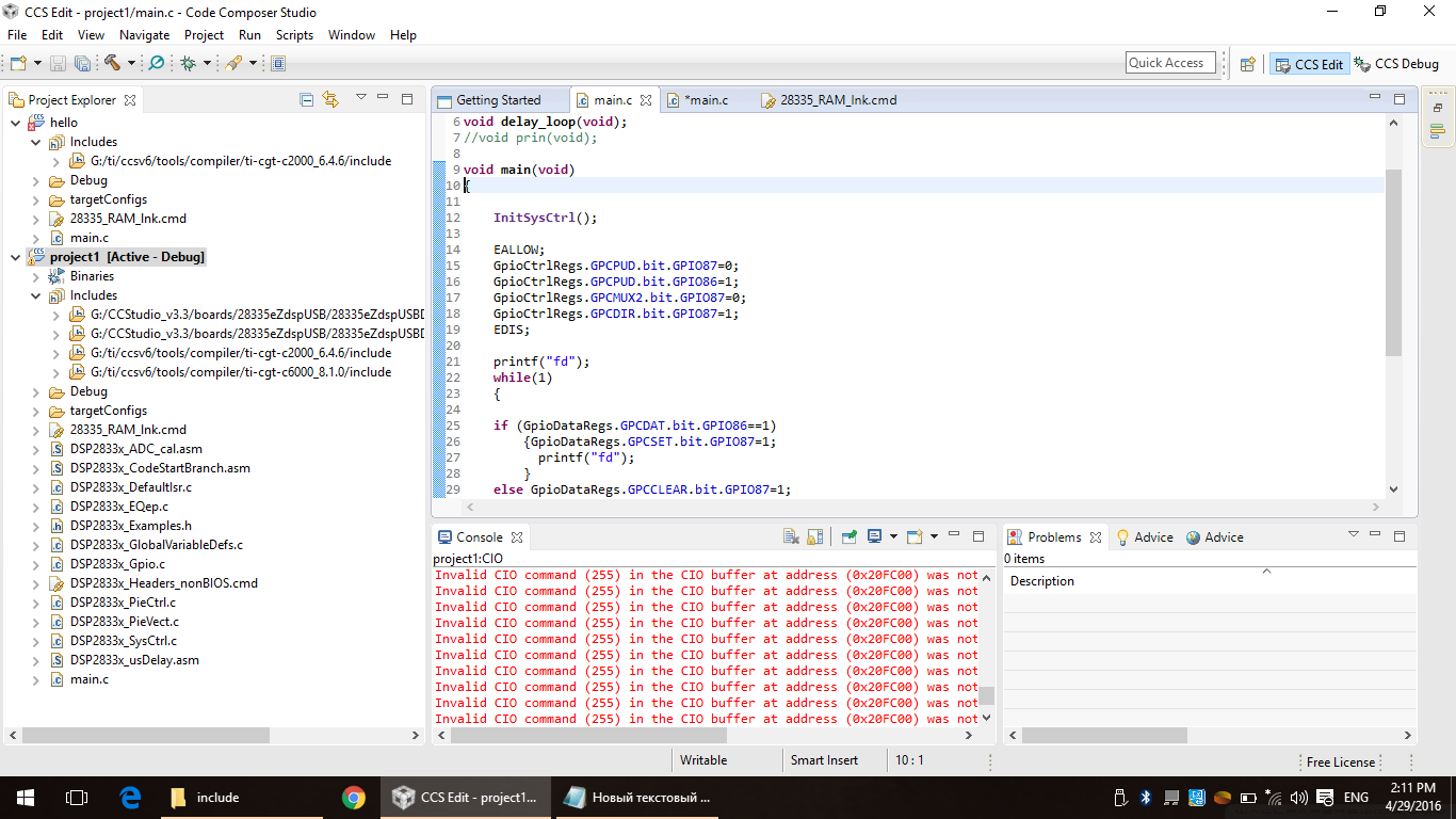

  • Also, if you want to select a specific serial port, you should use fprintf and fputc.  A specific serial port is selected by setting the fd value of the FILE structure.
  • Change your command file to the following (I added.cio : > RAMALL, PAGE = 0)::

  • Hello Denys,
    Did my post fix your problem? If so, please select verify.
    Stephen
  • Last cmdcode is correct. everything is working. only small warning is occured.
