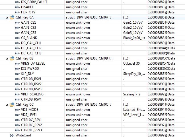

    DRV 8305 nFAULT led stays on when i turn on my power supply, i had to clear it by pressing the reset on f28027f.
  • Nvm Chris, i know why my board is getting a nFAULT is due to a voltage spike from my power supply. I think it went over the 45v limit.

  • John,
    Going past 45 V may damage the device.
    You can read the registers of the DRV8305 to determine what warning/fault is occurring.
    If it is a warning, a SPI read will clear the nFAULT pin. If it is a fault you will need to write a 1 to the CLR_FLTs bit to clear the nFAULT pin (you should determine why the fault is occuring though).
  • Thanks Nick, i'm not sure how to look at the registers. Is it under ccs debug registers?
    John
  • if you are using INSTASPINUNIVERSALGUI (either standalone or inside CCS) there is a DRV8305 tab to view the registers.
    per the source code you could also view the registers in your Expressions by expanding gDrvSpi8305Vars

    This is what i'm getting after expanding gDrvSpi8305Vars
    gDrvSpi8305Vars struct _DRV_SPI_8305_Vars_t_ {...} 0x00008840@Data

    wish i could attach a screenshot, is there anything wrong with it?
    John
  • John,
    That just looks like the memory addresses. If you expand each of the Stat registers these will be the fault and diagnostic bits. You can compare against the datasheet for more information.
  • Nick, i expanded the gDrvSpi8305Vars expression, but i don't see values next to the FAULT , please see attached screenshots.
    Do you see anything wrong with it? Resume/reset would clear the nFAULT, otherwise it stays on.
    Thanks.
