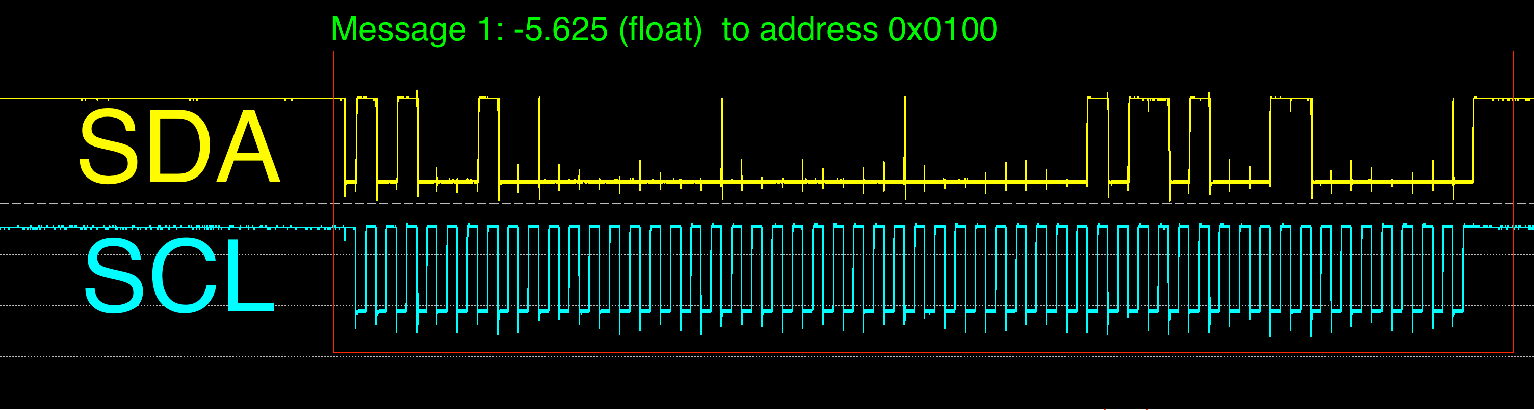

Hello all,
I'm writing an I2C implementation to read and write values directly between a local memory pointer on my 28027 and an EEPROM. The problem I'm running into is when I do writes in serial.
Symptoms:
  1. First write completes successfully (as far as I can tell)
  2. Second write gets NACKed for a period of time (corresponds with the write delay indicated in the EEPROM datasheet: http://www.mouser.com/ds/2/268/21710c-76077.pdf)
  3. Eventually NACK subsides, and the CPU hangs when attempting to write the data bytes for the second write (
I'm using adapted code from several examples seen in ControlSuite and on the forums. A couple of important notes:
  • I am currently using the FIFOs. Given what I'm reading on other I2C/EEPROM related posts, I'm not sure if this is the right move.
  • I am using the interrupts for Stop condition and RegReady
  • I've constructed a simple I2C message queue (a basic LinkedList implementation) to manage the list of values I want to read/write. This code has not been included below, but happy to if necessary.
I've included as much relevant code as I can think of below. Any help would be greatly appreciated.

  • Brian,
    Can you clarify what you mean by "the CPU hangs when attempting to write the data bytes for the second write"? An oscilloscope capture of the transfer would also be nice.
  • Hey Adam,
    Thanks for the follow-up.
    Specifically, I never break out of the while loop in i2c.c line 57 (transferring the data bytes for the message). Both the XRDY and ARDY registers resolve to zero indefinitely.
    Will work on grabbing a scope capture for you.
    Thanks again,
    - Brian
  • Hey Adam,
    Finally able to get a clean capture of the scope. I've annotated it to the best of my abilities for clarity, but please let me know if there's more info I can provide.
    Important: in my original post, I had a few errors in my code. The EEPROM I'm using actually requires the block address to be sent via the control byte, and I've enabled the second ISR to eliminate the "hanging" effect mentioned in my initial reply. I've updated the code in the original post to reflect all the latest code.
    Order of operations in the capture below is as follows:
    1. Write a 4 byte float (-5.625) to address 0x0100.
    2. Attempt to write a second message several times, get NACKed while first write cycle completes.
    3. Write a 2 byte uint (1234) to address 0x0140.
    What I'm reading from this capture is that the lower portion of the address (0x40) is being written between the two data bytes for the uint.
    First Message (Successful)
    Second Message (Failed)
    Full Scope Capture
    Thanks again for taking the time,
    - Brian
