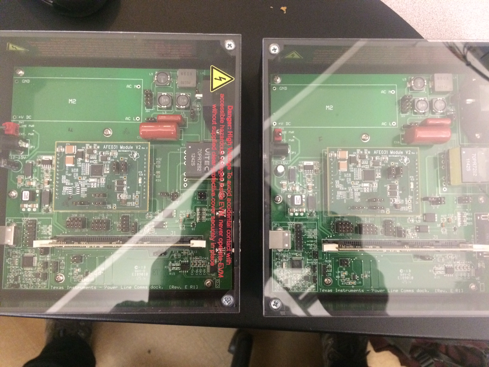

I just got TMS 320 C2000 with 2 modems inside the box. I am power electrical engineer but my professor would like to know how to set up these modems and use it in PLC application.
So I would like to have some hints how to set up and connected to the computer?
what I should do?

hi Ossama,
You can find the details on how to run and the Sw details in the below link .
please use SCI -B instead of SCI A as the kit used in the package is the latest kit v4 instead of the v3 that you have .
Regards.
