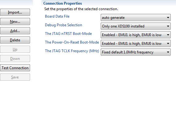

hi,
Yesterday we were working on the TMS320F28335 Control card  with docking station an having some experiments on hardware setup.
Everything was alright since last 3 months we are using this 28335 Experiment kit.
We powering up this docking station by external DC adapter for the safty purpose.
Yesterday while we writing into the flash of the control card suddenly electricity went off and control card stopped getting supply during the writing process.
Now its showing error message
Error connecting to the target:
(Error -1015 @ 0x0)
Device is not responding to the request. Device may be locked, or the debug probe connection may be unreliable. Unlock the device if possible (e.g. use wait in reset mode, and power-cycle the board). If error persists, confirm configuration and/or try more reliable JTAG settings (e.g. lower TCLK).
(Emulation package 6.0.83.1)
I checked in E2E forum and everything from hardware side it is all perfect. i also tried using  wait in reset mode by setting up the EMU1 as High and EMU0 as Low. and then started debugging Still its showing the same error.i have attached the SS of this setting.
The result of JTAG Integrity test is as follow,

What else i can try to Unlock it and if it can't be unlocked then to whom i can raise request to replace the controller?
This isn't Good approach as Power failure during writing to flash led to Lock the control card.
