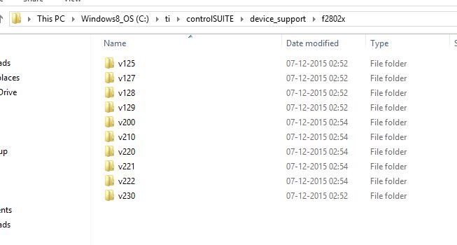

  • Can you try code from a different software version?
  • means ccs another version?
    In my office there is no other version and if i have to install i need admin rights which is risky.

  • No! I meant sample code versions:
  • Still I am facing same problem.
