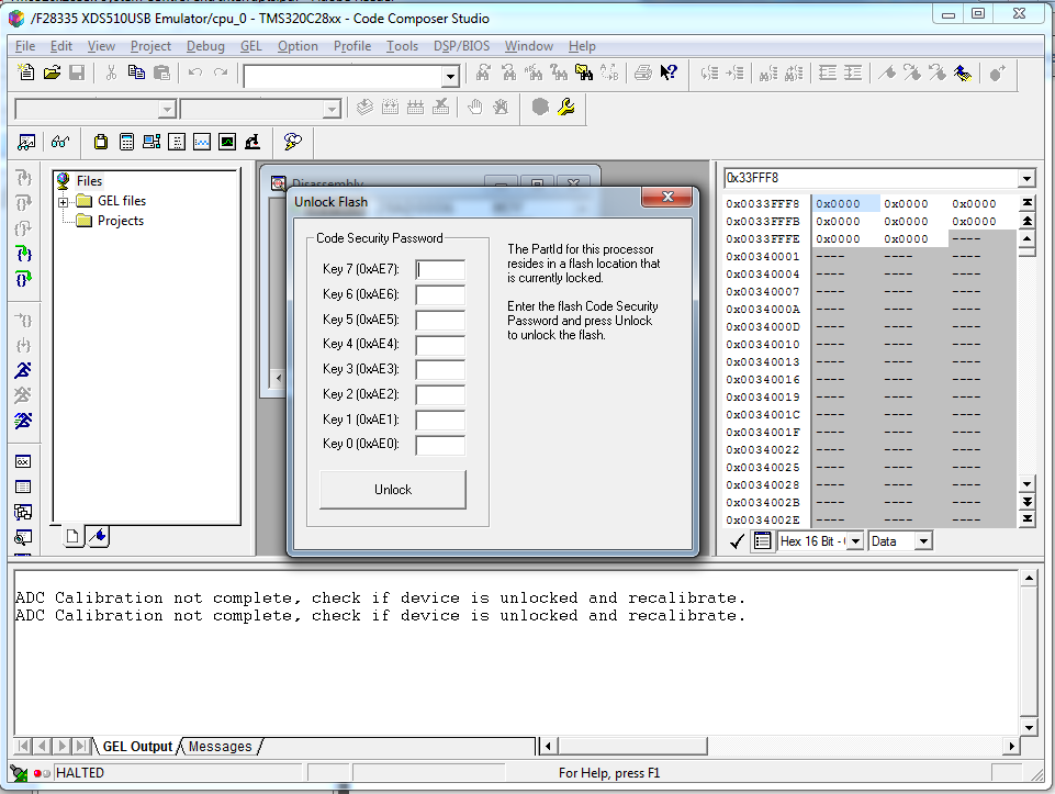

I am using a TMS320F28335 controller and recently the flash got locked. And I am not able to unlock it. So I am unable to flash code into controller.
 I have tried to access the password storage memory locations, but it shows 0x0000h (locations 0x33FFF8 to 0x33FFFF) data. I have tried to put default value (0xFFFF) for unlocking the flash but it didn't work. It gives a messege showing 'check whether password data locations are writeable'..
I am attaching the screenshot of memory map, Can anybody please help me out to unlock the controller?
