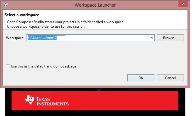

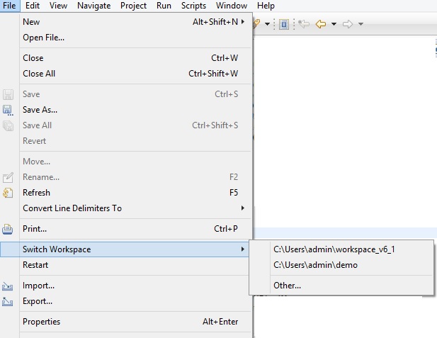

  • Hi Hank,
    You mean that this is unavailable:
    If so,  can you try shifting/creating a new workspace @ the introductory splash screen?
    Once you're at the new workspace -> check for the Switching Workspace option. It should be available now.
    Gautam
  • Hi Gautam,
    The problem was that I had ticked the box to start with the default workspace and that left me with no option to switch on startup. I had also selected the "CCS Simple" perspective which removes the Workspace entry from the File menu. I found the setting to uncheck the 'use default without asking' and also found that using a different perspective returns the normal File menu.
    thanks,
    hank
