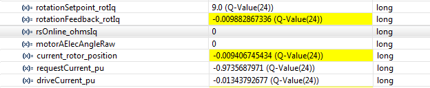

my question is my problem because I can not ask my position control a greater rotation of eight, or rather the difference between demand and feedback so the position error must not exceed 8 would otherwise go towards negative values.
example
request 9
current position 0
error should be 9 but in reality I have -7 and accordingly the request to the current controller is to turn in the opposite direction to -7.
here are two images that explain what happens at the output of the position controller
rotationSetpoint is the set point
rotationFeedback is the current position
requestCurrent_pu is the output of the position controller and consequently the input of the controller foc.
  I configure wrong my controller or is a limitation of istaspin.
wrong output because is negative instead has to be positive

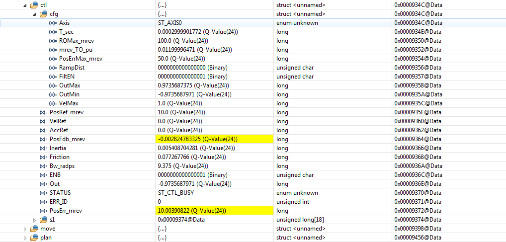

    When you motor is running can you take a screenshot of all the values in st_obj.pos.ctl.cfg and st_obj.pos.conv.cfg?
  • Hello Adam,
    here is what is required, as you can see
    my request is 10 rev
    feedback (actual pos) 0 rev
    PosErr_mrev, give to me a proper error value 10, but the the result in out of the controller is bad because is negative, because it want to bring the shaft  to -6 rev (because surpassing 8 I restart at -8 and 10-8= 2 rev ramaning )

  • Andrea,
    I was able setup my simulation similar to how yours is configured.
    I'm able to see the same thing and the underlying cause is that SpinTAC is not designed for steps that large.  When the controller was converted from floating point to fixed point it wasn't conceived that someone would have a position error that large.  The controller is expecting to be used with a profile generator which reduces large errors.
    I understand that in your application you want to change to the new position setpoint as quickly as possible.  I think you should consider still using the profile generator in order to make the transition.  If you set the curve type to trapezodial and increase the curve limits to be the maximum you can get to the goal position just as quickly and it will settle on the final value faster.  I've taken screen shots for comparison purposes below.
