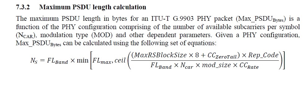

I'd like to understand how is correlated the: UINT16 length;  -> // PPDU buffer length in bytes of the G3_EXAMPLE_PHY_PROJECT with the other parameter as: number of subcarriers, number of tones, data rates, modulation etc.
For example, I tried to modify the lenght from 73 to 85 and the TMDSPLCKIT-V3 doesn't send the paket. So, what is the relationship?

    Have you checked Physical layer specification(section 5.2: SYSTEM FUNDAMENTAL PARAMETERS) for length calculation formula?
    You cannot just change the data length. Please look at the formula and check what all values you have to modify.

    I checked PHY specification and I found two formula:
    --THIS IS THE FIRST:
    ---THIS IS THE SECOND:
    Now my question is: The "//Length of PPDU payload in bytes " in the C-code is referred at the first forumla or at the second one?
    I know that based on the sort of modulation, rate etc I have to adjust the forumla but I have not understand the concept of the SYMBOLS to put in the formula, e.g:
    Can you help me to understand how I have to use the formula?
