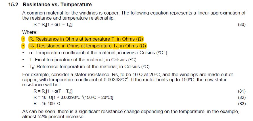

Hello TI,
I'm trying to estimate the motor temperature through the change in winding resistance. There is a formula on spruhj1f.pdf chap 15.1 that is relating temperature and resistance, Is R0 resistance at temperature T0 same as the resistance estimated on lab2? can i use the lab7 RsOnLine_Ohm as the final temperature to calculate the final T? Thanks!
