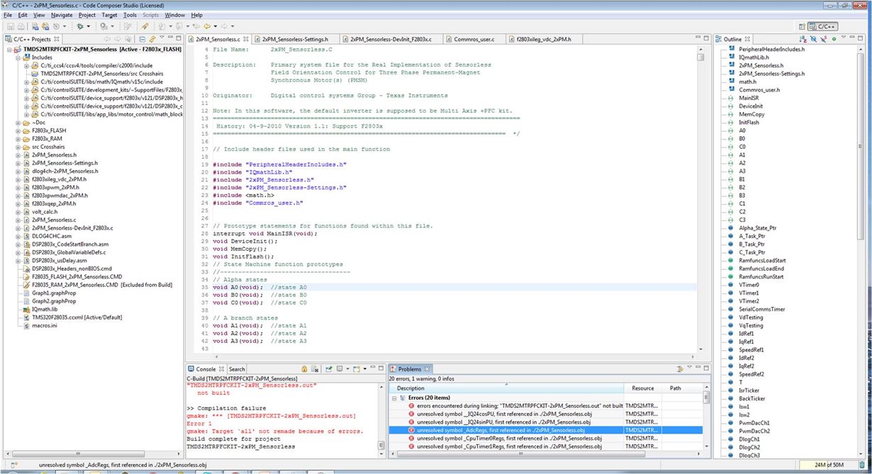

Using ControlSUITE example for kit referenced above.
Got a build error, "could not open source file "PeripheralHeaderIncludes.h"
Where does TI recommend I get this file from?  And the peripheral headers that it references?

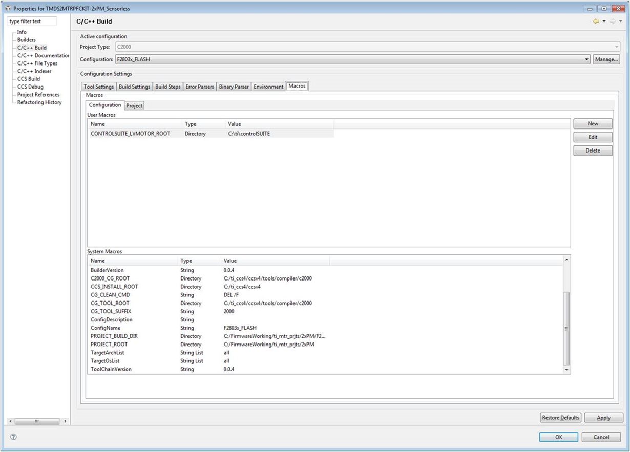

  • In project properties, a link existed for the header file via a macro named CONTROLSUITE_LVMOTOR_ROOT.  I could not find a definition for this macro.
    I noticed that PeripheralHeaderIncludes.h is in the ControlSUITE directory.  I created a user macro that points to this directory.
    So now I have a different set of include path directory errors.
    For a kit that is supposed to work out of the box, I am encountering some interesting roadblocks.

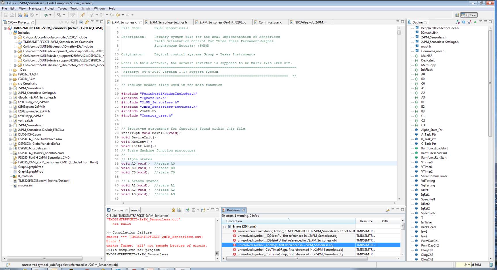

  • Hi Vincent,
    First of all, I'm sorry for the issues you are having.  I went ahead and imported this project into my CCSv6.1 installation and the project was able to compile with no issues (in the FLASH build configuration).
    A few questions:
    1) When you imported the project into CCSv4, did you select the option to "Copy project into workspace"?  If you did, you shouldn't.  The copy option directly effects the ability for the path variables to be generated correctly.
    2) Is it possible for you to try with CCSv6?  In addition to having a sign from me that project was able to compile with CCSv6, it is also a newer version of the software and will therefore be better supported.
    Please let me know how things go.
    (I notice that in your screenshot, DSP2803x_CodeStartBranch.asm [and others] have a yellow exclamation point next to them and are showing that CCS cannot find those files - this means there are more pathing issues which *could* be resolved manually.  However I would recommend reimporting the project since it will likely be less painful)

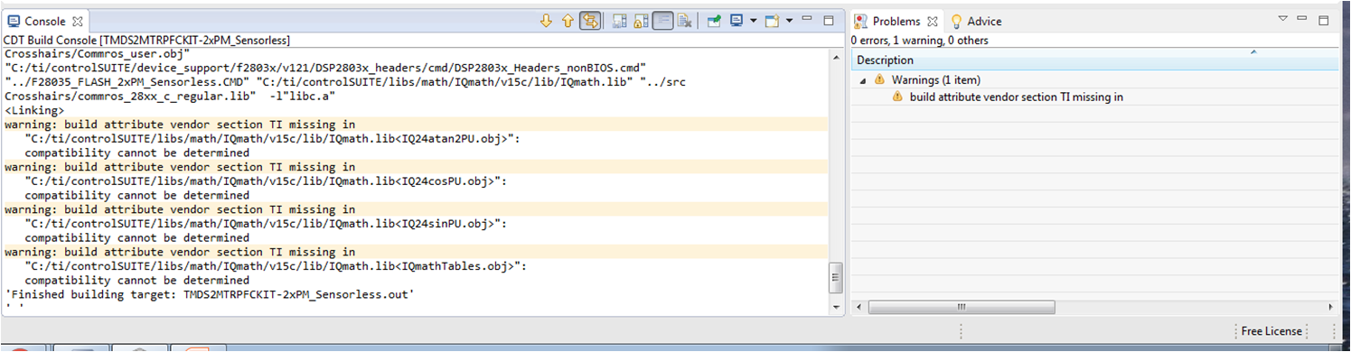

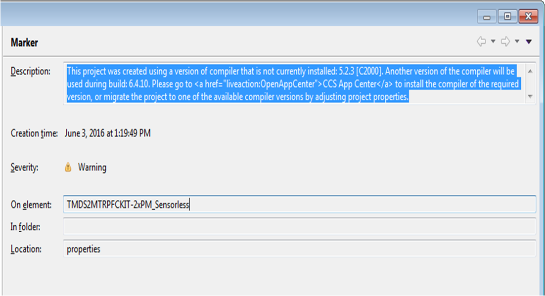

    I imported the project into CCS 6.1.  Then I got a warning about the project being created in a different compilier version.
    I went into project properties and changed the compilier version to 6.4.10.  After a rebuild I got the following warning:
    What does this message mean?  Do I need to rebuild the libraries?  If so, how do I rebuild them?
  • Hi Vincent,
    No, TI owns the source for these libraries.  They were compiled with an older version of a compatible compiler.
    These libraries work and these warnings can be ignored.

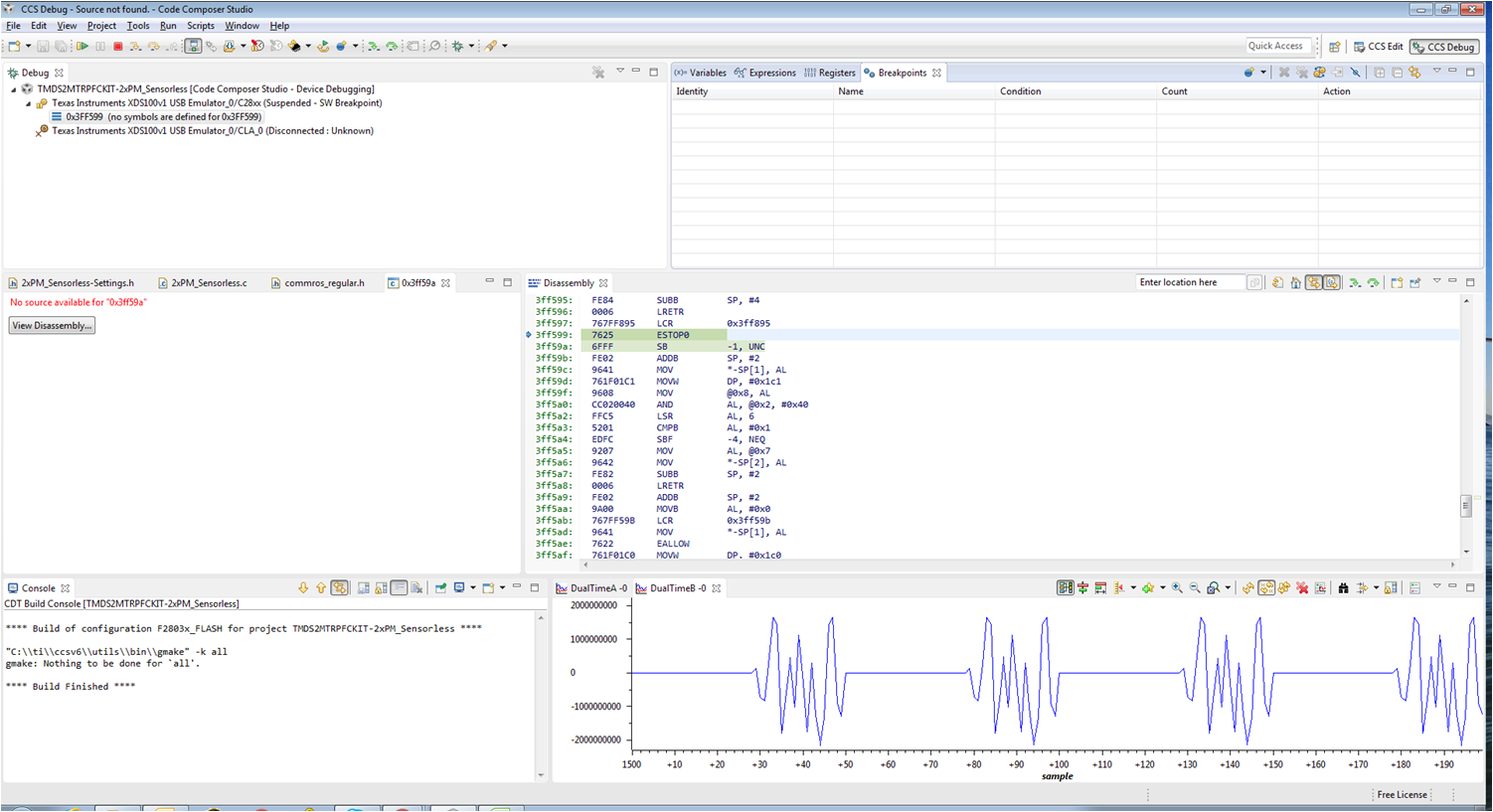

  • I tried to run the system and it looks like it is hitting a software breakpoint.  However, I don't see anything on the breakpoints list.  Any idea what is happening here?
  • Hi Vince,
    We are looking into this.  I just had a colleague compile, load and run the various incremental builds onto a controlCARD + Docking Station hardware combination.  He didn't run into any issues.
    I am going to have him try and run the project on the actual kit as well and see what occurs.
    When does the issue occur?  Immediately after hitting the 'run' button?

  • Brett,
    Thank you very much for the update.
    Yes it pretty much does occur right after hitting the "run" button.
    I looked at the linker command file and it looks like 0x3ff59a is part of the bootblock partition. I am not really familiar with the f28035 device so I am not sure how the boot memory space is supposed to be setup.
    It seems like there is no bootloader code on the device. Although, since I am running with a debugger, I am not sure why I would need a bootloader.
    Thanks again and I look forward to your update.
    -Vince
  • Vince,
    After loading, can you try to hit the 'reset' button, next the 'restart' button, and then 'run'?
    Thank you,
    Brett
  • It looks like that solved it. Thank you very much for your help.

    After shelving the project for awhile, I tried to load the project into flash and ran into this issue again.  After I load code it shows "(Suspended - SW Breakpoint)" and  "(no symbols are defined for 0x3FF599)"
    CCS version is 6.1.1.00022
    Any ideas as to what is happening here?
  • Setting up a new target configuration seems to have resolved this issue.
