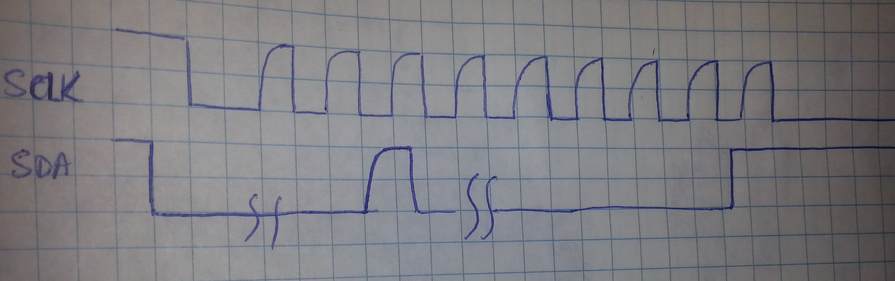

  • I make it working  I had to keep the I2C module in RESET while programming the clock.
    but my system still not working :  I am trying to send 4 bytes using the FIFO mode  , after the 9 clock pulses the clock stay low , any help ?

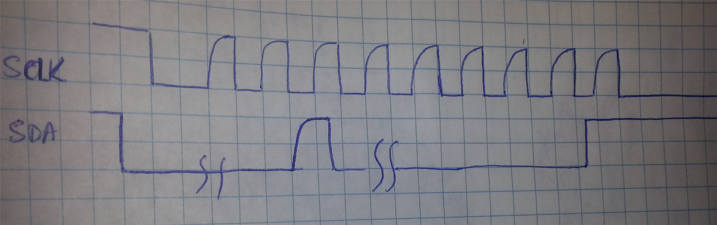

  • I just attached the waveform
    any help will be appriciated
    Hamid
  • Hamid,
    It looks like the data is getting NACKed. Do you have a slave connected?
    Please try setting STT and STP before you write the data.
  • Hi Adam,
    Thanks for getting back to me.
    Yes I have a Slave connected  and the problem was with the slave. Now it is working fine.
    Hamid
