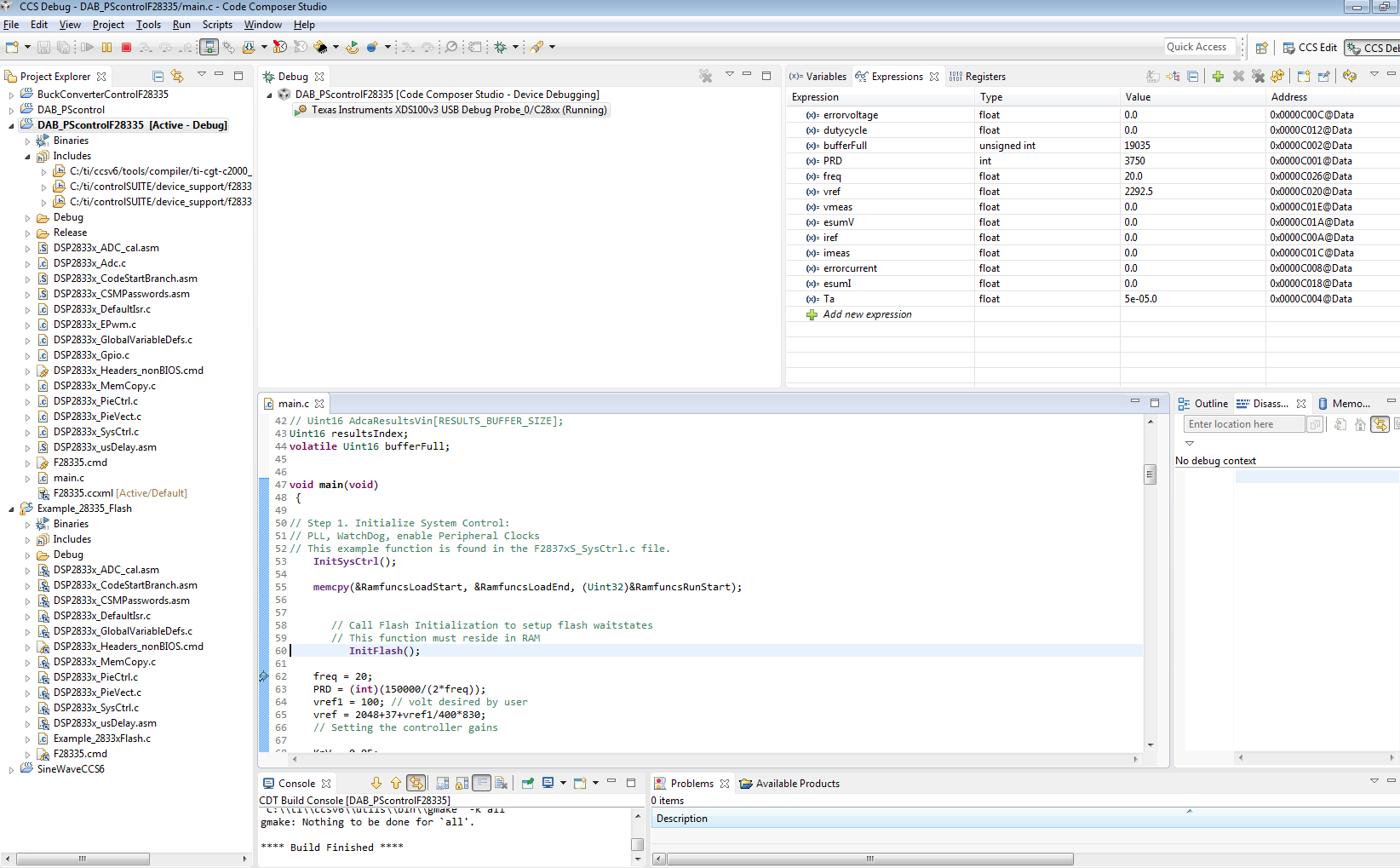

Hello everyone,
I am trying to run a program from flash but face some issues with that for which I need some help. In general: I generate PWM signals (ePWM1 and ePWM2) and do an ADC reading inside the adc_isr. Using RAM, the code works perfectly fine. To program in flash, I followed the SPRA958L reference and the example "Example_28335_Flash" from controlSuite very closely. What I did:
1. Remove the 28335_RAM_Ink.cmd from my project
2. Add the F28335.cmd into my project (Right click on my project -> Add files -> F28335)
3. Add the following piece of code into my main function:
	/*** Initialize the PIE_RAM ***/
	PieCtrlRegs.PIECTRL.bit.ENPIE = 0; // Disable the PIE
	asm(" EALLOW"); // Enable EALLOW protected register access
	memcpy(&PieVectTable, &PieVectTableInit, 256);
	asm(" EDIS"); // Disable EALLOW protected register access
4. Add the memcpy command into my code:
	// Copy time critical code and Flash setup code to RAM
	// This includes the following ISR functions: epwm1_timer_isr(), epwm2_timer_isr()
	// epwm3_timer_isr and and InitFlash();
	// The  RamfuncsLoadStart, RamfuncsLoadEnd, and RamfuncsRunStart
	// symbols are created by the linker. Refer to the F28335.cmd file.
	   memcpy(&RamfuncsRunStart, &RamfuncsLoadStart, (Uint32)&RamfuncsLoadSize);
5. Calling the InitFlash() function:
	   // Call Flash Initialization to setup flash waitstates
	   // This function must reside in RAM
	      InitFlash();
6. Activate the flash in my adc_isr:
// Activate flash
	   EALLOW;
	   FlashRegs.FPWR.bit.PWR = FLASH_ACTIVE;
	   FlashRegs.FSTATUS.bit.V3STAT = 1; // Clear the 3VSTAT bit
	   FlashRegs.FSTDBYWAIT.bit.STDBYWAIT = 0x01FF; // Sleep to standby cycles
	   FlashRegs.FACTIVEWAIT.bit.ACTIVEWAIT = 0x01FF; // Standby to active cycles
	   FlashRegs.FBANKWAIT.bit.RANDWAIT = 3; // F280x Random access wait states
	   FlashRegs.FBANKWAIT.bit.PAGEWAIT = 3; // F280x Paged access wait states
	   FlashRegs.FOTPWAIT.bit.OTPWAIT = 5; // F280x OTP wait states
	   FlashRegs.FOPT.bit.ENPIPE = 1; // Enable the flash pipeline
	   EDIS;

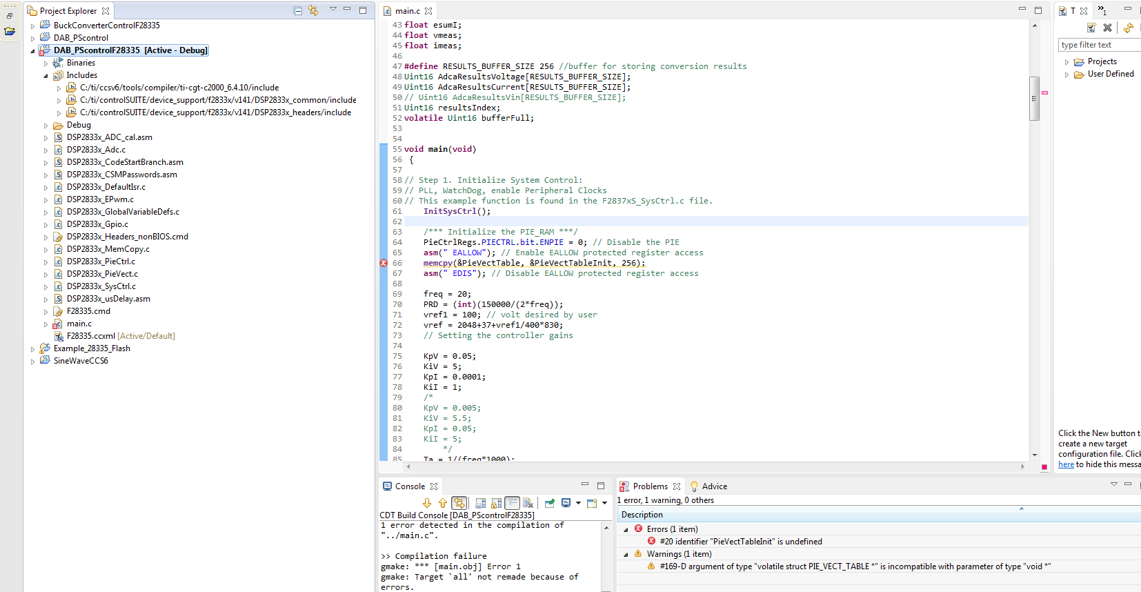

When I click the "Hammer tool" button in CCS, I get the error "#20 identifier PieVectTableInit is undefined". I guess I miss something that I cannot see. The complete code of my project:

A screenshot after compiling:
Any help is highly appreciated. Thank you.
  • Hi guys,
    I got some progress on the flash programming issue. I followed the guidlines from SPRCA73 - under section 3.2.2 Linker Command Files, and figured that most of the code is already provided in the *.c files from controlSUITE.
    In fact, my steps as for now are:
    1. Remove the 28335_RAM_Ink.cmd file
    3. Add the memcpy into my main loop:
    	/*** Added user code ***/
    	memcpy(&RamfuncsLoadStart, &RamfuncsLoadEnd, (Uint32)&RamfuncsRunStart);
    4. Calling the InitFlash() function:
    	      InitFlash();
    My full code of my c-file is now:

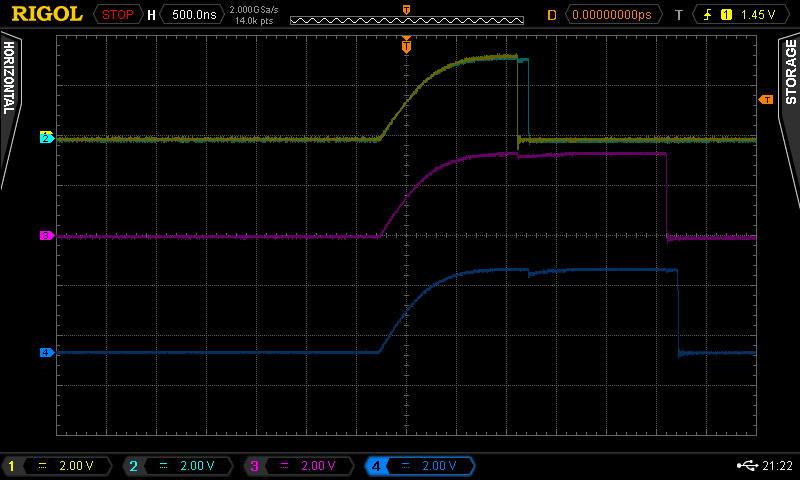

    I measured 4 PWM signals (ePWM1A/ePWM1B/ePWM2A/ePWM2B) on the corresponding pins via an oscilloscope. Please have a look at the measurements:
    Do you have a guess of why the PWM signals are not repeating and are only for such a short time?
    Thank you.

    I played a bit with the debugger and it seems I never hit the ISR. In particular, based on the code I am posting in THIS thread, I will never make it to the breakpoint shown in the screenshot.

    In fact, it seems that I never leave the InitAdc(); function because I never hit the breakpoint set at DINT;
    Funny enough, if I place the lines
    	      InitFlash();
    at the beginning of my main() function right after InitSysCtrl(); I will never leave the InitFlash(); function and will never make it to the next breakpoint.

    In the SPRA958L note on page 9, it says that I need to copy the interrupt vectors. This, I have NOT done because the compiler gives me an error shown here:
    Any ideas?

    I have some good and bad news regarding my problems with programming in flash. First of all, I generated a new minimalistic project which only generates a 50% duty cycle on ePWM1 module (any other ePWM modules and the ADC are removed). With this new minimalistic project, I can program to flash and everything works as intended. This got me curious such that I extended my program adding the ADC functionality. And now it does not work anymore.
    In particular, when adding the InitAdc() function into my code, my program will never leave that function. Please have a look at the two pictures below where I am in debug mode and set a breakpoint to my InitAdc() function and to DINT; after my InitAdc() function. As you can clearly see from the two figures, my program never leaves the InitAdc() function.
    Do you (or anyone else from TI) have an idea of what could possibly be going on here? I also attached the NEW code for the sake of completeness.
    With InitAdc() enabled - breakpoint at InitAdc():
    With InitAdc() enabled - breakpoint at DINT never occurs:
    With InitAdc() disabled - breakpoint at DINT; occurs:
    The complete c code:

    // User defined
    int PRD;
    int freq;
    extern Uint16 RamfuncsLoadStart;
    extern Uint16 RamfuncsLoadEnd;
    extern Uint16 RamfuncsRunStart;
    void main(void)
    	// Step 1: Initialize system control
        InitSysCtrl();
        freq = 20;
        PRD = (int)(150000/(2*freq));
        	// Step 2. Initialize GPIO:
        	// This example function is found in the F2837xS_Gpio.c file and
        	// illustrates how to set the GPIO to its default state.
            InitGpio();
            // These functions are in the F2837xS_EPwm.c file
            InitEPwm1Gpio();
    //        InitAdc();  // For this example, init the ADC
            // Step 3. Clear all interrupts and initialize PIE vector table:
            // Disable CPU interrupts
            DINT;
            // Initialize the PIE control registers to their default state.
            // The default state is all PIE interrupts disabled and flags
            // are cleared.
            // This function is found in the F2837xS_PieCtrl.c file.
            InitPieCtrl();
            // Disable CPU interrupts and clear all CPU interrupt flags:
            IER = 0x0000;
            IFR = 0x0000;
            // Initialize the PIE vector table with pointers to the shell Interrupt
            // Service Routines (ISR).
            // This will populate the entire table, even if the interrupt
            // is not used in this example.  This is useful for debug purposes.
            // The shell ISR routines are found in F2837xS_DefaultIsr.c.
            // This function is found in F2837xS_PieVect.c.
            InitPieVectTable();
            // Interrupts that are used in this example are re-mapped to
            // ISR functions found within this file.
            EALLOW; // This is needed to write to EALLOW protected registers
            PieVectTable.EPWM1_INT = &epwm1_isr;
            EDIS;   // This is needed to disable write to EALLOW protected registers
            // Step 4. Initialize the Device Peripherals:
            // For this example, only initialize the ePWM and ADC
            EALLOW;
            SysCtrlRegs.PCLKCR0.bit.TBCLKSYNC = 0;
            EDIS;
            InitEPwm1();
            EALLOW;
            SysCtrlRegs.PCLKCR0.bit.TBCLKSYNC =1;
            EDIS;
            MemCopy(&RamfuncsLoadStart, &RamfuncsLoadEnd, &RamfuncsRunStart);
            InitFlash();
            IER |= M_INT1; // Enable CPU Interrupt 1
            // Enable EPWM INTn in the PIE: Group 3 interrupt 1-3
            PieCtrlRegs.PIEIER3.bit.INTx1 = 1;
            EINT;          // Enable Global interrupt INTM
            ERTM;          // Enable Global realtime interrupt DBGM
