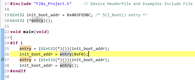

Option 1: Change the boot mode to Get Mode and then, in your main flashed code, you can decide to call the bootloader for SCIBoot IOOption2 (in the bootROM) always or based on whatever is desired.

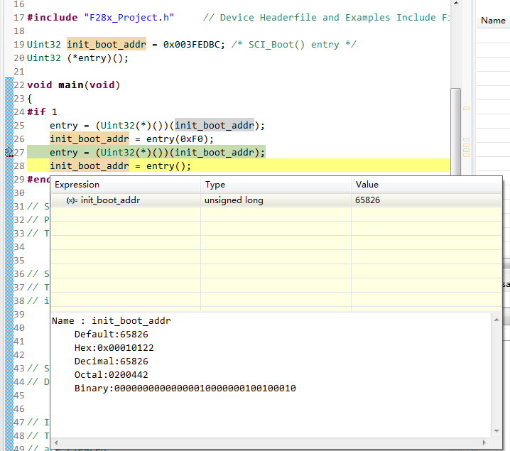

1. For option 1, how does the user to call the bootlader for SCIBoot IO option2 in the main flash code? In Get Mode, the Zx-OPTBOOTCTRL will be used to decide the boot procedure as shown below.
As the Zx-BOOTCTRL register is OTP, the boot procedure will be fixed permanently. So, how to implement "base on whatever is desired"?
