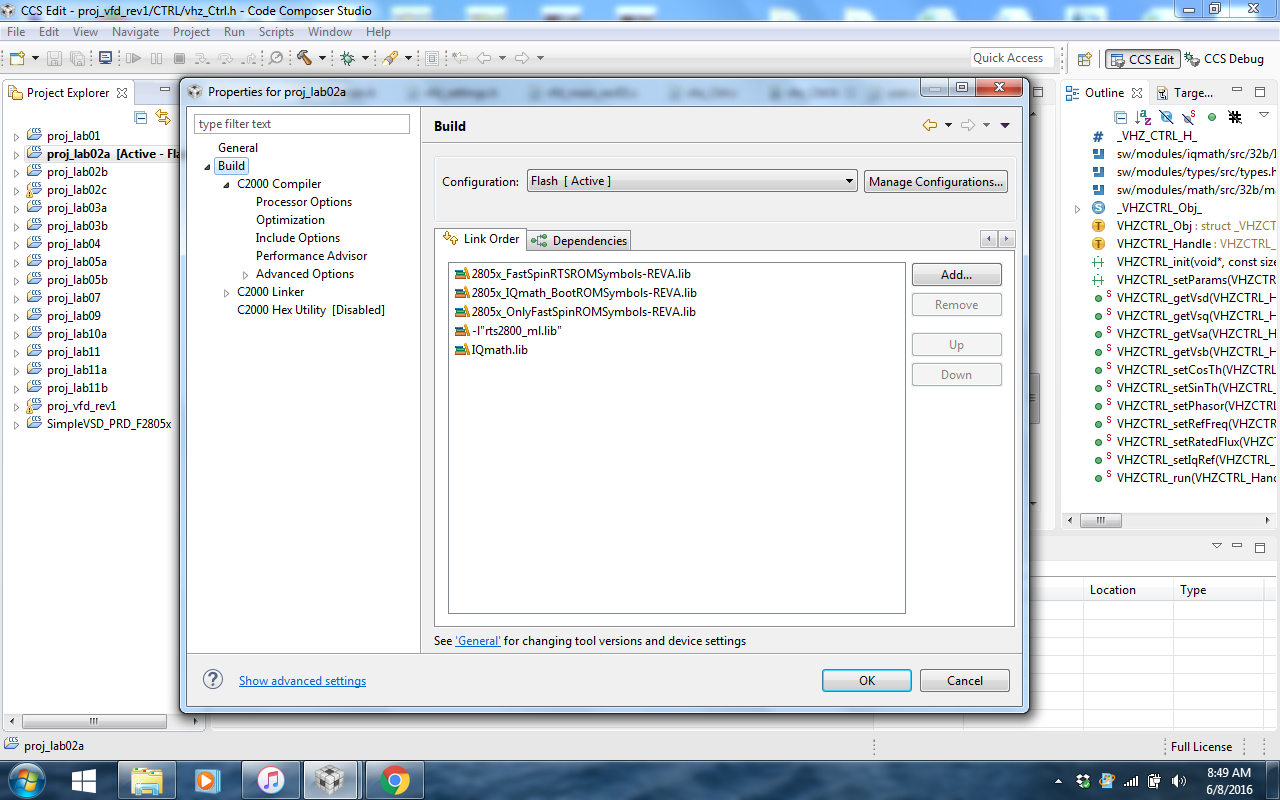

*** CRITICAL **** Do NOT use CCS v6.1.3
Other Parts Discussed in Thread: MOTORWARE
We are investigating the cause and the fix.
CCS v6.1.3 is not following the correct (and critical) link order we define in Project Settings --> Build --> Link Order
This is similar to the compiler bug that affected us with 6.2.0-6.2.2 (the fix for the compiler was to hard code these link order settings)
