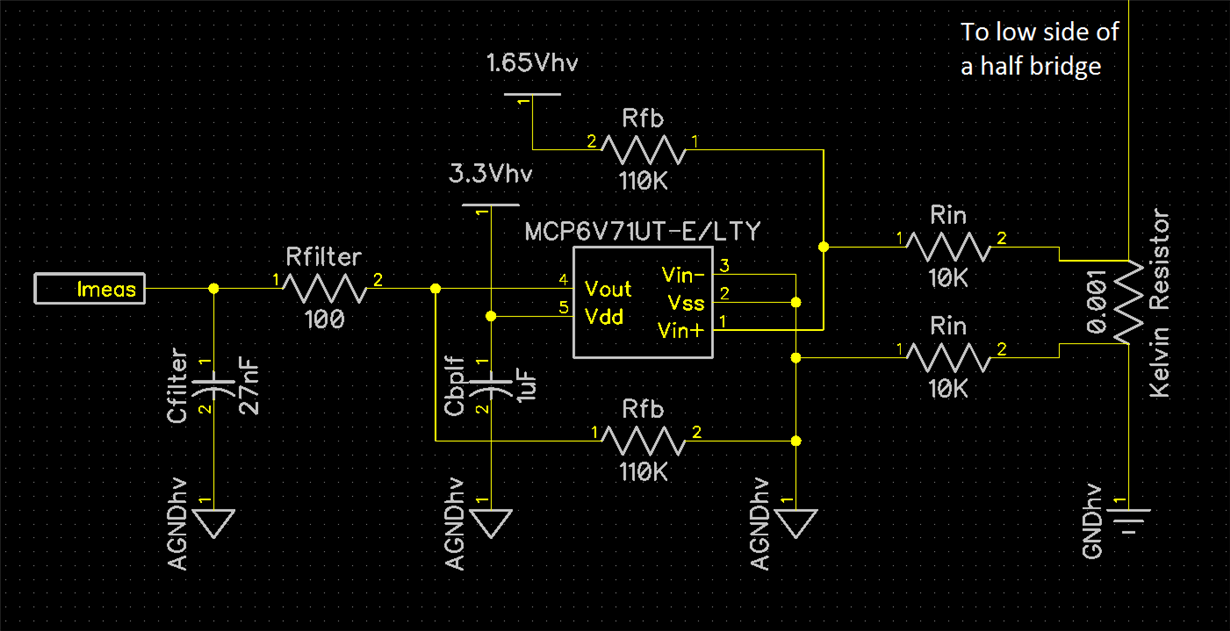

  • Hi Phil,
    It looks like Chris read your post a little quickly because you are indeed using a high pole-count low inductance (54uH) low phase-phase resistance (5.7milliohm) traction motor.  I do believe your calculation of 30A of ripple current at 45kHz is correct (took a look at the paper you linked).  You will need to pay careful attention to the design of your DC bank capacitors to be able to safely handle that ripple current without overheating and failing.  I suggest the following Article as a good reference for understanding ripple current and it's implications on your DC-link bus.  I believe the reason Chris suggested 45kHz is that many motor controllers use 20kHz switching to prevent audible noise from the motor windings and since you're using a low inductance motor a double in the switching frequency is a convenient place to start in reducing the ripple current.  You'll have to make a trade-off between switching losses at high frequencies vs. larger ripple currents at lower frequencies when deciding on the appropriate switching frequency.  A second trade-off with higher switching rates in reduced PWM resolution.
    I have serious concerns about your choice of shunts and current measurement scheme.  The reason(s) why low side current sense is probably a bad idea in your application is that the current can only be measured when the low-side FET/IGBT is conducting.  This means that at 45kHz you only get 22us for a completely settled current measurement at best case (low output duty cycle) and about 1.3us worst case (high output duty cycle) - this is based on SVPWM (Space Vector PWM) modulation.  Getting a completely settled current measurement in 1.3us is tough, especially when you will require 20x to 50x gain from your current sense amp, you'll need op-amps with 50MHz or greater gain-bandwidth and a high slew rate of 20V/us or more.  With this added bandwidth and gain, noise and transients susceptibility will be increased.  Here is something else to consider, the phase-to-phase resistance of your motor is 5.7milliohms, at 300V that's a lot of stall current which leads into why either using a LEM or an isolated shunt with delta-sigma modulation on the motor phases is a better idea than the low-side current sense.  If you measure current on the motor phases you can detect motor phase shorts to GND and POWER which are extremely dangerous at the voltages and potential fault currents you are dealing with.  In addition, the current on the motor phases is continuous and mostly sinusoidal at a low frequency so the bandwidth of your current measuring circuit can be very low which will result in a cleaner current measurement and a lot less headaches.
    -Jesse
  • Phil,
    I can't disagree with your thought process. I was coming at from the angle of you want as high of PWM as possible...and with InstaSPIN-FOC the highest hardware based decimation is a PWM 3x the control system rate. Due to the 60 MHz CPU we are limited to the ~15 KHz controller rate, which puts the PWM at 45 KHz. On the 90 MHz devices it's easier to run 20 KHz and 60 KHz. You can add in some SW decimation but we haven't done it much ourselves. There are also PWM limitations with the driver chips we have used on our EVMs.
    When using shunts at high speed the sampling windows get small. Once you add in using low inductance high short circuit current motors you make it that much tougher.
  • Hey Jesse and Chris,
    I looked into DC link capacitors and found a pretty good solution with AVX Corporation's FB series. This 30uF capacitor can handle 16Arms. By putting anywhere from 3-5 in parallel I can limit the bus ripple voltage to between 5V and 3V respectively at 20kHz when using that Emrax motor. At 20kHz there would be 70Apk-pk of ripple current which is 25Arms, so they handle that as well. Going over 20kHz does make a lot of sense in terms of audible noise. I'll look into the IGBT power loss and driver circuitry associated with increasing PWM frequency and see if it is feasible (currently all specced for 20kHz).
    The reason I decided upon shunts was that chapter 17 of the InstaSPIN user guide made them sound very feasible for control at ~20kHz. My current setup is a 3 shunt low side configuration using a MCP6V71UT as the op amp in a difference amplifier configuration. This meets the suggested 1V/us slew rate and since I have a 0.001 ohm shunt, I was going to use a gain of 11 with an offset of 1.65V. In this manner I could measure my continuous current of 75A with Vmin = 1.65 - 0.001*75*11 = 0.825V to Vmax = 1.65 + 0.001+75*11 = 2.475V. All of this comes at a power loss of ~6W when running at 75A which corresponds to <0.03% power loss with a bus voltage of 300Vdc. I've attached the relevant schematic for one of the phases. I propogated the error through to the ADC and its less than 1.25% (most error from the 1% shunt resistor). I hadn't really thought in terms of measuring motor shorts to ground and power. I see how an LEM on the motor phases would make much more sense in terms of safety!
    One big question I have is how current is measured when it has such a high peak to peak ripple. How can I be sure that I'm measuring the mean current, rather than low or high current peaks? Does InstaSPIN measure current in the middle of the PWM wave form so that it captures the current as it reaches its mean (assuming approximately linear current vs. time due to the short time scale).
    Additionally what is considered a nominal amount of ripple current? For instance running that Emrax motor at a PWM frequency of 20kHz gives 70Apk-pk which seems like a lot, even though its not enough to upset the DC link capacitors. How much torque ripple and magnetic losses would that much current manifest itself as?
