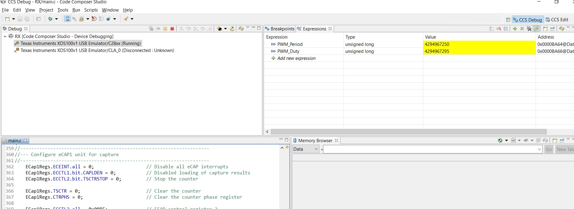

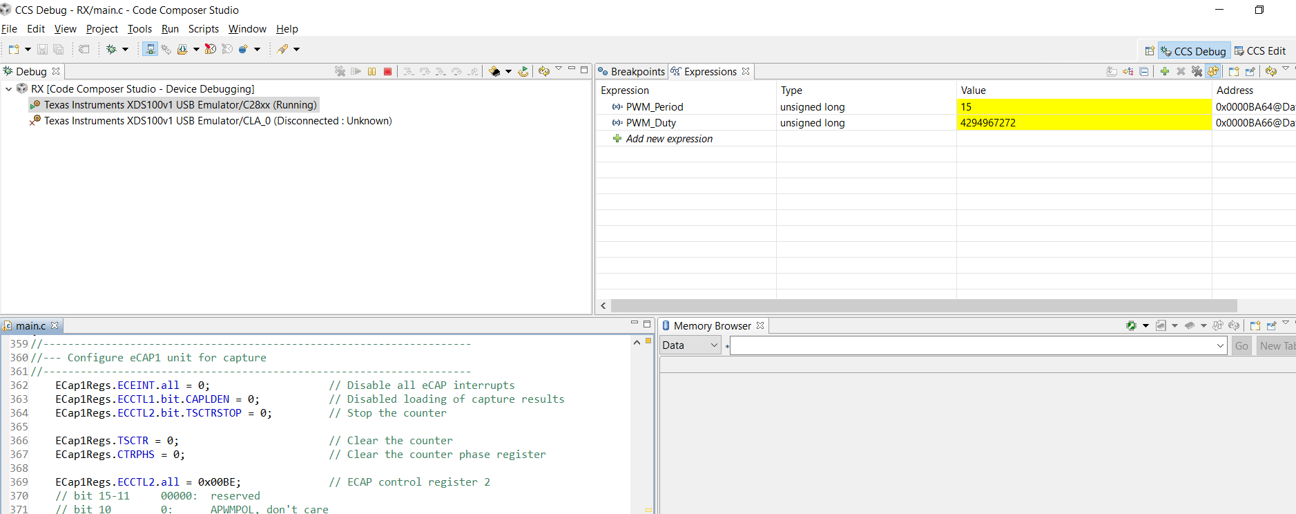

Hi everyone,
I have some trouble with my C program on CCS studio.
I'm using the F28069 microcontroller and I'm trying to follow the Lab7_10.c Example that I have attached here.
The difference compared to this one is that I'm using a function generator in order to generate the square train of pulses (not the PWM module of the microcontroller) , so I just connect the GPIO24 eCAP to the output of the function generator (1KHz - 1Vpp).
The problem is that when I print PWM_Duty and PWM_Period they do not correspond to the values generated from the function generator, rather, these values are meaningless.
Can someone help me with this program?
Thanks in advance,
Andrea

  • Andrea,
    I notice you are using an F28069, whereas the file you attached was written for an F28335.  Although the eCAP registers are in similar address ranges, these are very different devices and must be initialised differently.  For example, the GPIO pin allocation is completely different.  I suspect your problems stem from this.
    There is an example in the header files for the F28069 which shows how to configure and use the eCAP peripheral to capture inputs on GPIO24.  Can I suggest you try the example "ecap_capture_pwm" in the controlSUITE header files at:
    C:\ti\controlSUITE\device_support\f2806x\v151\F2806x_examples_ccsv5\ecap_capture_pwm
    Richard
  • Hi Richard,
    I forgot to mention that I included the F28069 files and I reshape the program (with the right GPIO) accordingly for the F28069 microcontroller.
    However I'm going to try the example in the controlSUITE, I'll let you know.
    Andrea
  • Hi Richard,
    I tried the example but again doesn't work. Something change at the output but the values are incorrect.
    They changes randomly.
    I'm using a square signal with 1Vpp and 50% DC and 2KHz. (Even if I change the values, nothing happen. The values changes continuously and randomly)
    Can you help me with the code?
    Andrea
  • Andrea,
    Can you start with the basic example, straight out of controlSUITE, and check that works on your board?  That way you'll have some base-line code you can start to build on.  The variables in your watch window are not in that project so I guess you have added something.
    Once you have that working you can remove the ePWM3 connecting wire and apply your own test input to eCAP1.
    Richard
  • Hi Richard,
    I tried with the controlSUITE example but again didn't work. The output continue to change and have random values.
    The "good news" is that something happen but it is like that the eCAP is not able to hook up with the signal.
    I'm waiting for your support,
    Andrea
  • Andrea,
    If we can get the basic example from controlSUITE to work for you then at least you'll have a starting point for your code.  The example I'm using runs on the F28069 and is called "ecap_capture_epwm".  In controlSUITE, from the default installation directory, you can find it at:
    With this, you should be able to make a simple jumper wire connection between PWM3A and eCAP1 and watch the interrupts as the PWM edges are captured.
    Unfortunately, when I tried this there is an error in the code which assigns GPIO5 (rather than GPIO19) to eCAP1.  So, you'll need to make that jumper connection between GPIOs 4 & 5, not 4 & 19 as it says in the source comments.  If you're using a LaunchPad those connections are on adjacent pins (35 & 36) on J4.
    I'll submit a bug for that error.  Can you try this and see if you get the capture to work?
    Richard
