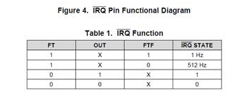

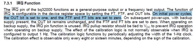

Also I tried to generate test signal of 512Hz from IRQ pin of BQ32000(according to pages 7-8 of datasheet)
But it remains in high level as on initial power cycles of device.
