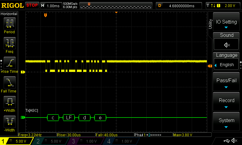

Hi Everyone!
I am new to F28377S device, I got LAUNCHXL-F28377S to get started. I met an issue with transmitting messages from the board to PC. I am trying to send two test strings "abc" and "def". I used example sci_echoback from the controlSUITE v191, CCS version is 6.1.3.00033 . Here is a code:
#include "F28x_Project.h"
void scic_echoback_init(void);
void scic_fifo_init(void);
void scic_xmit(int a);
void scic_msg(char *msg);
void main(void)
   char *msg;
   InitSysCtrl();
   InitGpio();
   GPIO_SetupPinMux(62, GPIO_MUX_CPU1, 1);
   GPIO_SetupPinOptions(62, GPIO_INPUT, GPIO_PUSHPULL);
   GPIO_SetupPinMux(63, GPIO_MUX_CPU1, 1);
   GPIO_SetupPinOptions(63, GPIO_OUTPUT, GPIO_ASYNC);
   DINT;
   InitPieCtrl();
   IER = 0x0000;
   IFR = 0x0000;
   InitPieVectTable();
   scic_fifo_init();
   scic_echoback_init();
   while (1)
		msg = "abc\0";
		scic_msg(msg);
		msg = "def\0";
		scic_msg(msg);
void scic_echoback_init()
 	ScicRegs.SCICCR.all =0x0007;
	ScicRegs.SCIHBAUD.all = 0x0002;
        ScicRegs.SCILBAUD.all = 0x008A;
	ScicRegs.SCICTL1.all = 0x0023;
// Transmit a character from the SCI
    while (!ScicRegs.SCICTL2.bit.TXRDY) {}
    ScicRegs.SCITXBUF.all =a;
void scic_msg(char * msg)
    int i = 0;
    while(msg[i] != '\0')
        scic_xmit(msg[i]);
        i++;
    scic_xmit('\n');
void scic_fifo_init()
    ScicRegs.SCIFFTX.all=0xE040;
    ScicRegs.SCIFFRX.all=0x2044;
    ScicRegs.SCIFFCT.all=0x0;

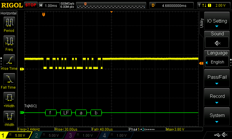

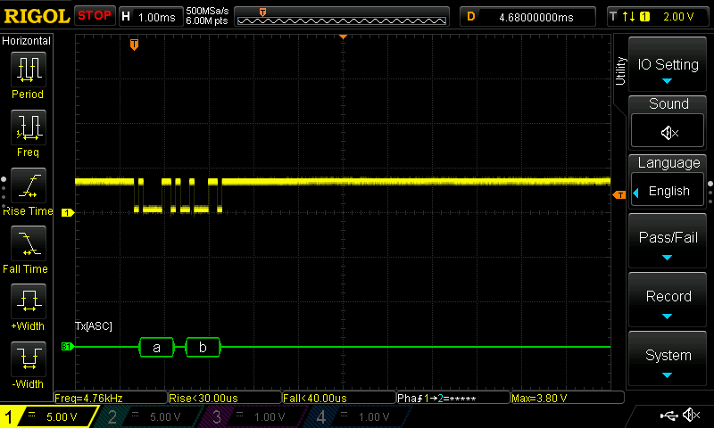

Issue is that strings are not transmitted as planned, bellow are images from oscilloscope.
First transmit of abc:
Transmit of def:
Next transmit of abc:
Could someone help me with advice, what did I miss?
