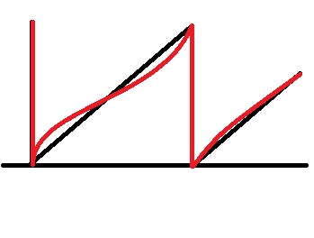

    Let me try to explain why the PLL would work with an example in the following image.
    The black line is how the encoder counter (QEP) should look like if the motor is running at a constant speed. Due to the wavy nature of the encoder, we rather have the red one. Of course for the current control loop that position estimate is bad, but if you differenciate it is even worse for the speed control.
    On the other hand if we manage to have a PLL locked in to the encoder counter, the PLL output should be a sawtooth signal with a perfectly constant slope and a frequency and phase exactly equal to the red curve (should look exactly like the black curve). Using the output of the PLL as our encoder counter, therefore, should eliminate any problem derived from the wavy encoder signal.
    I had a look to the PLL used in the solar library but I am afraid that is so different from the one I am trying to develop that is is not very useful. I have written a first version of such PLL in Matlab and it seems to work (at least in simulation) although I am a little bit worried about its dynamics and how it might respond to ramps in speed and things like that.
