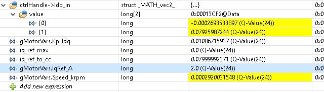

    I did this simple test and I got these results.
    First I added a variable to get the reference value of PI controller to the watch window by addingit inside the CTRL_runOnLine_User in ctrl.h.
    // get the feedback value
    fbackValue = CTRL_getIq_in_pu(handle);
    iq_ref_to_cc = refValue;
    // set minimum and maximum for Id controller output
    outMax = _IQsqrt(_IQmpy(maxVsMag,maxVsMag) - _IQmpy(CTRL_getVd_out_pu(handle),CTRL_getVd_out_pu(handle)));
    outMin = -outMax;
    // set the minimum and maximum values
    PID_setMinMax(obj->pidHandle_Iq,outMin,outMax);
    // run the Iq PID controller
    PID_run(obj->pidHandle_Iq,refValue,fbackValue,CTRL_getVq_out_addr(handle));
    I aso added Idq_in.value[1], iq_ref_to_cc, gMotorVars.Kp_Idq, gMotorVars.Speed_krpm,gMotorVars.IqRef_A to the watch window.

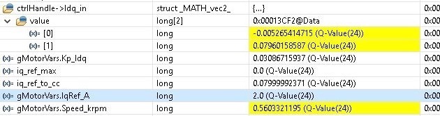

    1st test
    Without applying full load, I set gMotorVars.IqRef_A = 2.0. motor started rotate. I saw that reference value to current controller is iq_ref_to_cc = 0.0799999. And feedback to the current controller Idq_in[1] = 0.07960. looks like reference is very close to feedback. And input current to motor controller from the voltage source was 1.7Amps.  RPM =560.
    2nd test
    Then I reset  gMotorVars.IqRef_A = 0.0 and applied around  x10 large load to the motor and applied gMotorVars.IqRef_A = 2.0 again. Then I saw the same numbers on watch window as before. But motor did not spin and input current from source was 0amps. RPM = 0.
    I have few problems.
    1) Why the reference value to the current controller is not equal directly to  gMotorVars.IqRef_A  ?
    2) Are there any conditioning or scaling in between gMotorVars.IqRef_A and reference to current controller.
    3) Why the feedback for the current controller is same as reference current when the motor does not draw any current in test 2?
  • CTRL_getIq_in_pu
    pu is per unit
    0.08 per unit amps * IQ_CURRENT = 2.0 A
    so I'm guessing your IQ_CURRENT is set to 25A in user.h?
    I don't know what this refValue is
    I would look at the output of the PID Iq controller to see if it's saturating to the outMax
    I would guess that your setting of 2A is much too low for the 10x load

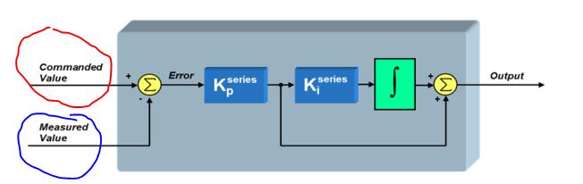

    "I would look at the output of the PID Iq controller to see if it's saturating to the outMax"  I will check this and update you.
    Chris, what my thinking was Idq_in.value[1] is the feedback (Measured) value for current controller and Idq_ref.value[1] (iq_ref_to_cc = refValue;) is the commanded (reference) value for current controller.
    "I would guess that your setting of 2A is much too low for the 10x load" I agree with you. Surely 2A setting should be a very low value for x10 load.
    But if the motor can draw 1.7A current from the source in less or no load condition for the iq_ref  2A setting, why the motor can not draw same amount of current  from source (0Amp) in x10 load for the same iq_ref 2.0A setting. It is true that the 2A setting is much too low for 10x load as you have mentioned. But shouldn't that draw the current(1.7A)  relative to 2A setting and produce some torque with respect to 2A setting (surely that can not rotate the motor with x10 load) ?
    In my 2nd test I saw that the Idq_in.value[1] (should be a measured value in pu) is very close to  Idq_ref.value[1] (should be a commanded value in pu) when the motor doesn't get any current. I was expecting very low value in Idq_in.value[1]. Is that possible?
  • I would encourage you to measure the phase currents directly and not rely on input measurement of your power supply. this will give you much better insight into what is happening with the motor.
    I still haven't seen that you have plotted the input IqRef vs. the output Vq
