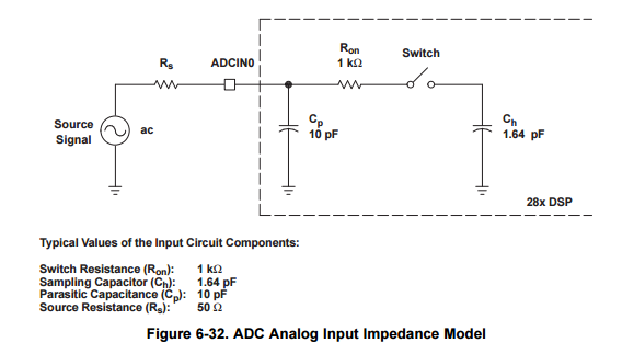

    The ADC will always close the S+H switch only for the duration of the S+H window (even if channels aren't changing between conversions) and this will usually result in some current flow in (or out) of the ADC input as the external driver and external capacitance equalize with the internal ADC channel capacitance.
    The ADC input looks like this:
    The effective Rs for your voltage divider is 7.5k || 2.49k = 1870.
    Cp is 100nF + 10pf = 100nF.
    We can use the formula (rs + ron)*Ch + Rs*Cp to get the time constant for settling on Ch. This gives 187us. To settle to within 1/4LSBs (typically how we define ideal settling) you need -ln((1/4096)*(1/4)) time constants = 9.7 time constants.  Therefore the required settling time is 1.8ms!
    This is much larger than anything you could set the S+H window too, but if we assume the external capacitor is fully charged when the ADC samples we can ignore the impedance of the voltage divider.  If we want the ADC to settle to about 1/4LSBs just via charge equalization with the external capacitor, then we need an external capacitor that is at least Ch * 4096 * 4 = 1.6pF * 4096 * 4 = 26nF. We meet this criteria, so we should actually be ok even using the minimum S+H window.
    Now if the voltage on the external cap drops by 1/4 LSB each time we sample, it won't stay fully charged forever.  The external op-amp will recharge the external capacitor, but this is subject to the impedance of Rs.  If we relax the allowable error to 1/2 LSBs on Ch, then at the beginning of the sample the external capacitor can be within 1/4LSBs of its final value (whatever the op-amp is driving it to) and then the sample will drain it to within 1/2LSBs.  The op-amp then needs to recharge it to 1/4LSBs in the time between samples.  This is half way from its starting point to its ideal point, so the number of time constants needed is -ln(0.5) = 0.7.  The external time constant is Rs*Cp = 187us, so the time between samples has to be longer than 187us * 0.7 = 131us.  This means the sampling rate can be no higher than 1/131us = 7.6kHz.
    The above assumes the worst case that the ADC s+h capacitor, Ch, starts completely discharged.  If this was the case, you would experience the settling error as an attenuation of the input signal, which wouldn't give you the non-linearity you are seeing.  In reality, there is some voltage leftover on the capacitor after a sample that is dependent on the ADC architecture, the previously converted voltage, and how long ago the previous voltage was converted.  You can try to remove this factor by sampling ground before your real conversion.  However a much better solution would be to reduce the sample rate or to reduce the input impedance driving the ADC input.
