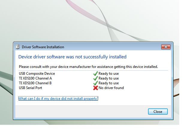

I think my windows couldn't install drivers for the kit i am trying to use. i couldn't find any driver file online .Is there any way to check for these drivers or any drivers online.

When you installed CCS, did you choose the option to install "TI Emulators"? If so, this should have installed the drivers that Windows needs.
Please note that with the portions of the kit that were able to find drivers, you should be able to connect your launchPAD to Code Composer Studio and begin evaluation. The driver that seems to be failing is the virtual comport driver, which you may not need.
If you want to see if you can get the last driver to install correctly, I might recommend that you try and run the .bat file located in the attachment of the following post:
