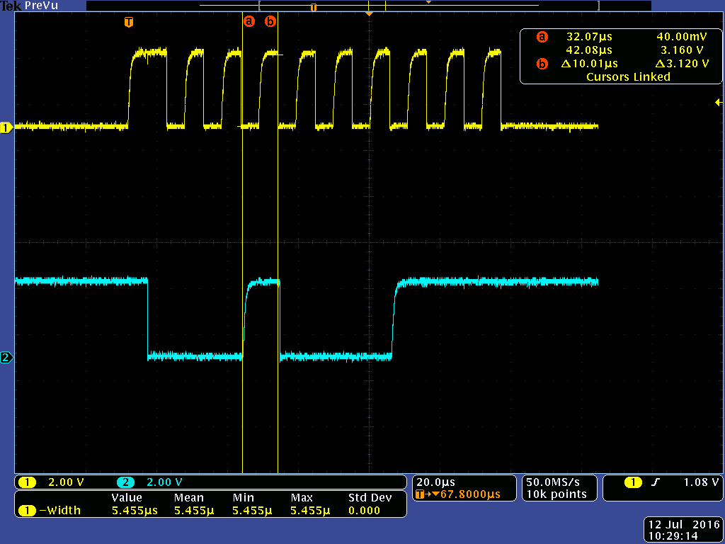

I am running a F28377D with a DS1775R+U temperature sensor attached to GPIO pins 0 and 1.
When I start my system, I am simply trying to read the base address of the sensor. The DS17775R+U is designed to continually place temperature data on the line on a read command unless otherwise configured. However, when I run my system, I see what looks to be an address being sent but I always miss the MSB of the address. I am using an I2C sniffer and when I try to send an address of 0x91(read), I get back 0x11 and when I send 0x90(write, I get back 0x10. Looking at the capture of the signal below, the clock doesnt look correct and could be the cause of the missing bit issue. All the timing diagrams that I see have the clock at a steady high value but mine always stays idle low. Is there a configuration setting to change that? Or looking at the code below does anyone see something incorrect that would cause me a bad address on the line.

    By default, the I2C module uses 7-bit addresses. It looks like your sensor expects a 10-bit address. To use 10-bit addresses, set the XA bit in the I2CMDR register.
  • I am not sure that I agree with the 10 bit address. I looked at the data sheet for the part(datasheets.maximintegrated.com/.../DS1775-DS1775R.pdf) and it certainly looks like a 7 bit address with an 8th bit to tell it read/write. According to the sheet, it looks like I would used 10010001(0x91) if I wanted to read from the device as a slave. Did you see something that says otherwise?
  • Hi Adam
    Seems that your device uses 7bit address. The address is 0x48 (1001000b), the read bit is appended to the address by the i2c module (when reading = 1, Writing = 0). Try with SAR.all = 0x48.
    Roger
  • Matthew,
    You're right, that is what the datasheet says. I was confused by your notation. There are two different ways of writing I2C addresses. The I2CSAR register expects data in 0x7f format, where the address bits are right-aligned. The read/write direction is determined by the I2CMDR.TRX bit, and is not technically part of the address.
    The other way of writing the address is 0xfe format, which left-aligns the address to mimic the 8-bit address byte from the start of an I2C transfer.
