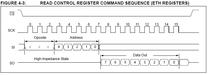

I am sending 0x0000 on the SPI interface for a control register read on a register whose value is 1111 1010 after reset.  I usually get the same (incorrect) value back which may prove to be the result of the high impedance state.  Regardless of clock alignment my sent data should be correct because it never toggles, but that means that the received data may be completely misaligned.
How does the RX interrupt function on the F28377S in terms of timing?  Are the transmission bits completely shifted out before bits are received?  In other words will it fit this timing diagram?
I suspect that either bits are being shifted in prematurely (before the end of transmission) or that the SCK signal from SPI is stopping operation prematurely, or finally that the SO pin is never leaving the High-Impedance state (The data that is being received is towards the upper end of possible values).
