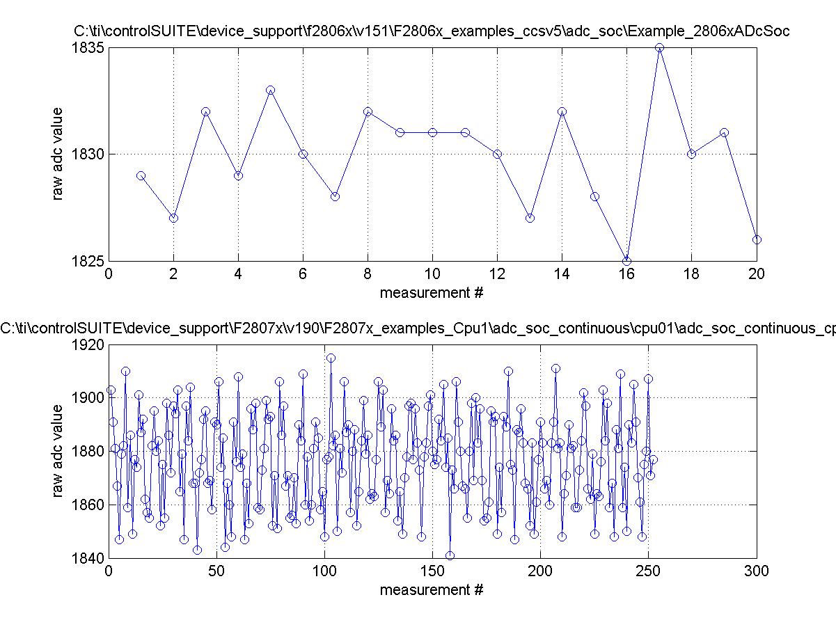

I found great noise in the ADC values of the F28057 control card with the 180 to 100 adapter and our own test hardware. I tried several things to reduce it (different signal sources, different reference voltages, emulator connections, power supplies, adc acquistion window sizes etc.), but did not succeed.
Finally, I reduced it to the following easyly reproducable experiment: I used a 1.5V alcali cell as a low effort, low noise, and low impedance voltage source and measured its voltage both with the 28069 and the 28075 control card using the software provided by TI in the control suite:
C:\ti\controlSUITE\device_support\f2806x\v151\F2806x_examples_ccsv5\adc_soc\Example_2806xADcSoc
C:\ti\controlSUITE\device_support\F2807x\v190\F2807x_examples_Cpu1\adc_soc_continuous\cpu01\adc_soc_continuous_cpu01
Here is a plot of the results:
The 28069 board on the 100 pin docking station shows not overwhelming, but acceptable performance (noise <=10 increments at ADC A4 to GND), but the 28075 on the 120/180 docking station is by factor 6 worse (about 60 increments noise at ANA 09 to GND J10)! Both measurements ran under the same conditions (power supply, emulator, environment).
Any similar or different experiences, any explanation?

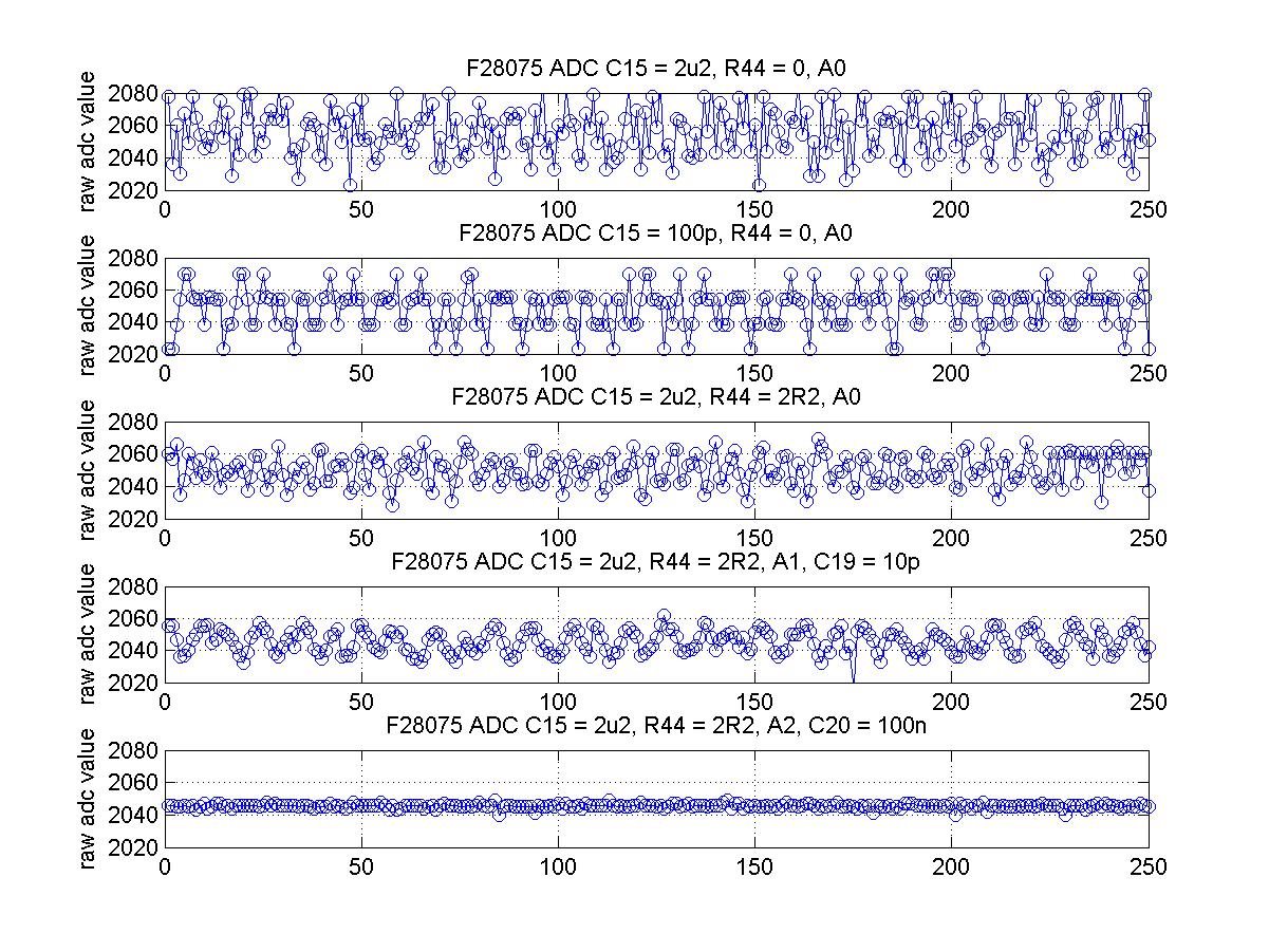

    According to your hints I did a couple of measurements, here are the main results:
    First I used the 3.0 V reference (changed SW2.1, SW2.2 on the control card in left position):
      The mean value of the conversion results changes from 18xx to 20xx ass expected, but still with bad accuracy.
    - The 3.0 V reference was measured to be 2.992 V (not calibrated multimeter),
      3.3 V reference is 3.29 V, both measured on SW2 to GND.
    - Scope measurements also look good on SW2 (U12 OPA4376 inputs). But on the U12 outputs (pins 1, 7, 8) I measured an oszillation of about 60 mV and 120 kHz, large enough to explain the measured adc inaccuracy:
     60 mV / 3.0 V * 4096 inc = 81.92 inc.
    I consulted the OP amp data sheet:
    www.ti.com/.../opa4376.pdf, p. 14 ff.
    Chapter 7.3.3 Capacitive Load and Stability
    The OPAx376 in a unity-gain configuration can directly drive up to 250 pF of pure capacitive load.
    Your designers applied a C15 = 2.2 uF - a little bit less than by factor 10.000 larger, see the schematics
    C:\ti\controlSUITE\development_kits\~controlCARDs\TMDSCNCD28075_v1_2\R1_1\F2807x_120controlCARD_R1_1_SCH_05Aug2014.pdf
    There is also a warning in the TMDSCNCD28075_Infosheet_v1_2.pdf:
    2.2 Warnings about Specific controlCARD revisions –
    Warnings about R1.1 and earlier controlCARDs:
    1. The circuitry used to drive the C2000 MCU’s voltage references on the controlCARD is not ideal.
    A nice euphemism.
    I replaced the 2u2 C15 with a 100p value and obtained a stable reference voltage VREFHIA unless there is no conversion in progress, the VREFHI is tied down with the conversions.
    The adc converted values look better, but now show a strange distribution, see the plot. There seems to be preferences of values near 2023, 2038, 2054, 2070 - a distance of 16 between the values.
    Then I replaced C15 = 2u2 and R44 = 2R2 to get something similar to the change suggested in F2837xD_VREFHI_12bitDrivingCkt.pdf, again with little improvements.
    Finally I tried the suggested Caps (10 pf, 100 nF) at the ADCINAx inputs. Only with the large 100 nF I get less than 10 increments noise.
    ADC settings are
    /* 120 MHz / 3 = 40 MHz, set ADCCLK divider to /3 (PRESCALE = 4) */
    AdcaRegs.ADCCTL2.bit.PRESCALE = 4;  // also tried 6
     AdcaRegs.ADCSOC0CTL.bit.ACQPS = 14; // up to 60, little effect on adc noise, but absolute value changes with low ACQPS values.
    SYSCLOCK is correct.
    Conclusion: The ADC not only needs to be carefully driven at its inputs, but also on its reference voltages.
    Here is a plot of the measurements.
    Will need some further work to find the right dynamic settings. Thanks.
    Frank
