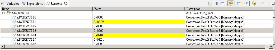

hi:
When I use F28020 ADC modul  find some chennal cann't  read ADC result .
set  ADC register as follow:

obver ,  I set  ADSOC3 and ADSOC4  same channel ,   but in ADCRESULT ,    has not same result.
ADC cofigurate is below:
and this is epwm soca  registor :
obver , we can see ETFLG is 0x0004 , that mean is socA is set . .
but whe I cann't get result3 ?
 please check it  ,please please !
