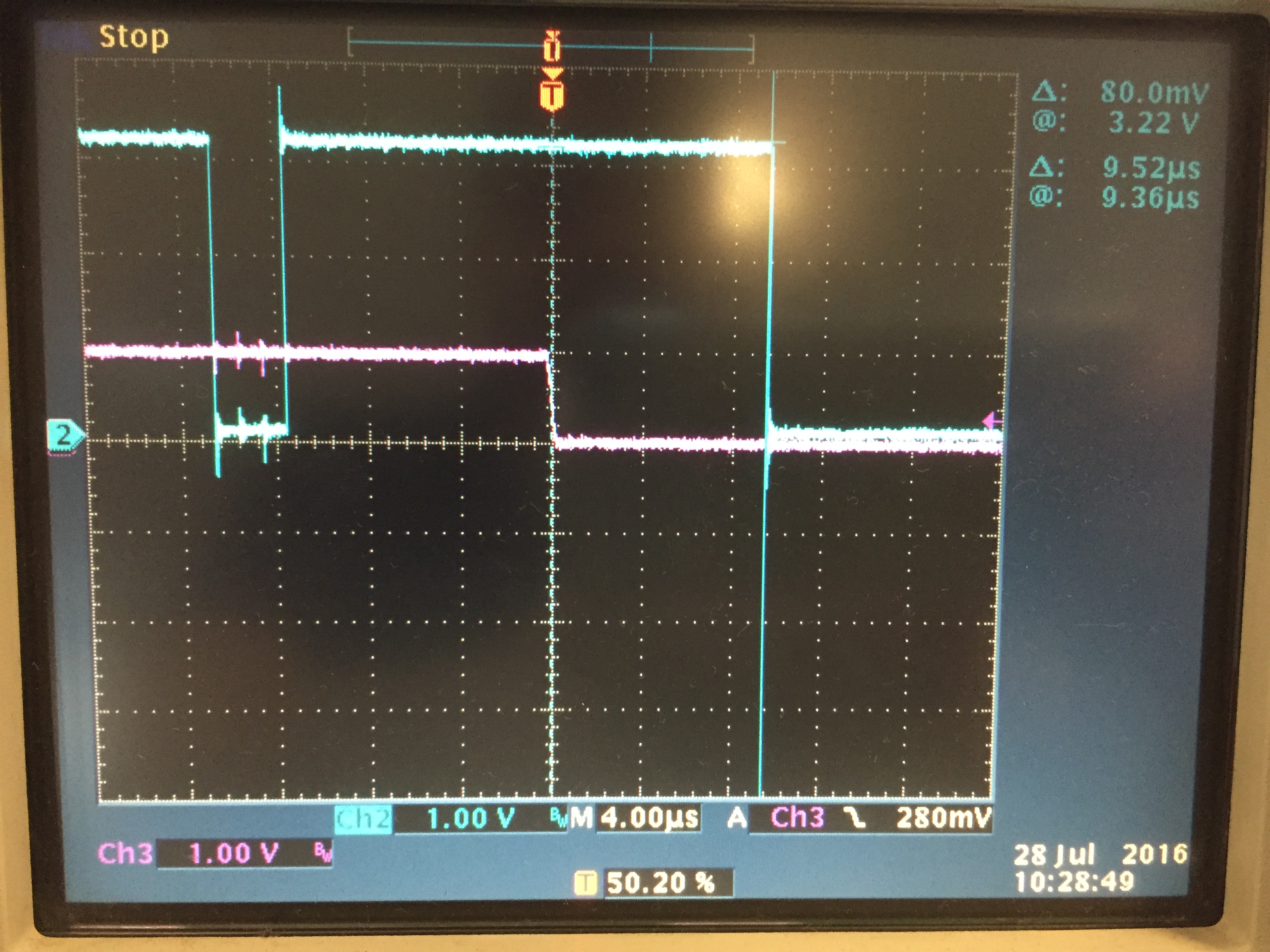

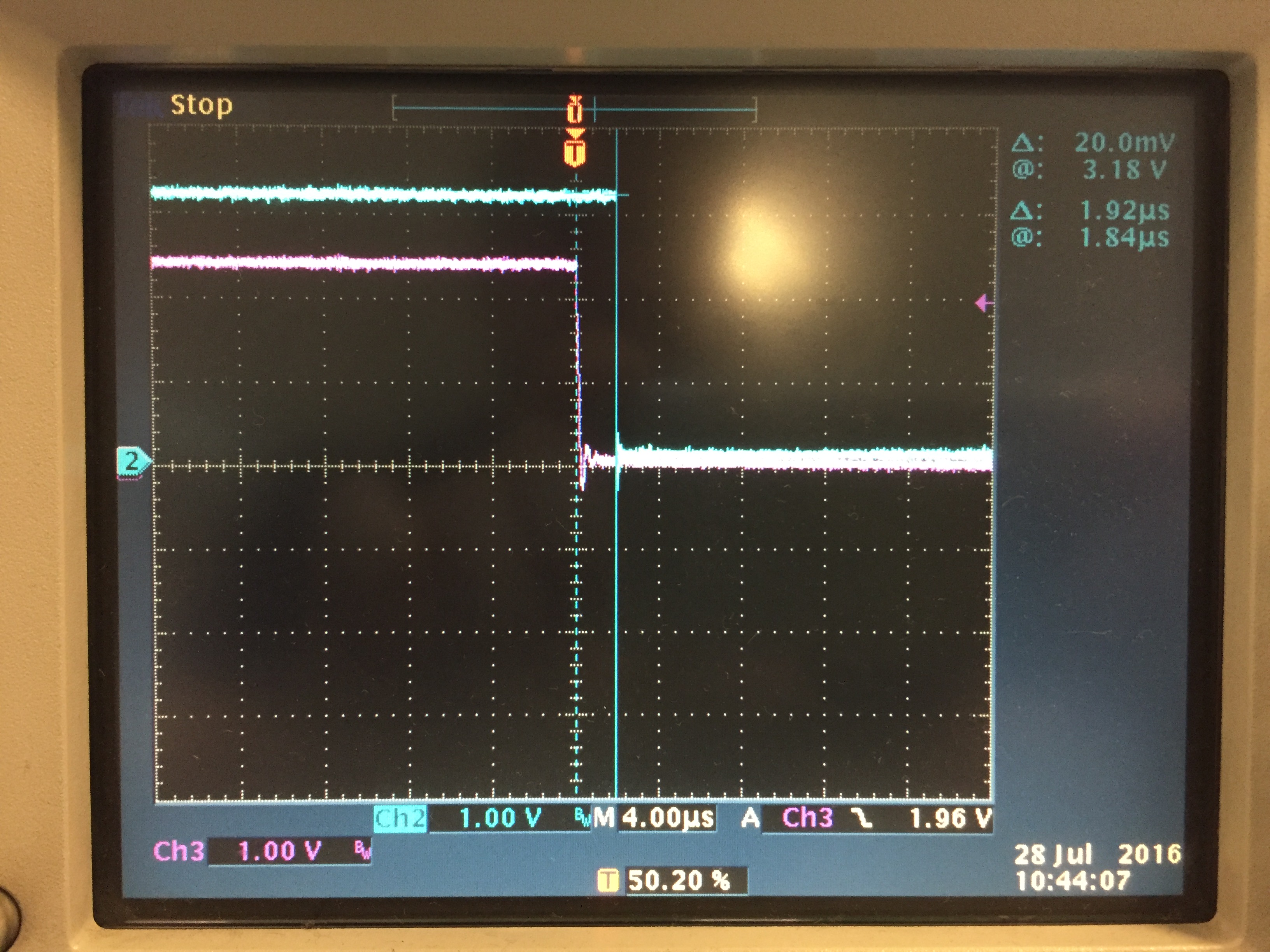

    I'll try to reproduce the behavior but in the mean time, can you post scope shots of what you are seeing?
  • CH2 Blue signal is epwm(or outputxbar, they are same), CH3 pink signal is comparator input(CMPIN1P). CMPSS1-COMPL is used as comparator. Comparator is configured with the code I posted before. Also, adc is sampling at 20kHz at the ADCINA2 which is the same pin with CMPIN1P.
    In the first picture comparator reference is approximately 2.0V. When the input goes below the reference, output becames low within 1.92usec.
    In the second picture comparator reference is approximately 0.3 V. In this case trip time is 9.52usec.
    Scope triggers at falling edge of the input(CH3) signal on both cases. Triger level is same as the comparator reference on both cases, 2.0V and 0.3V respectively.
