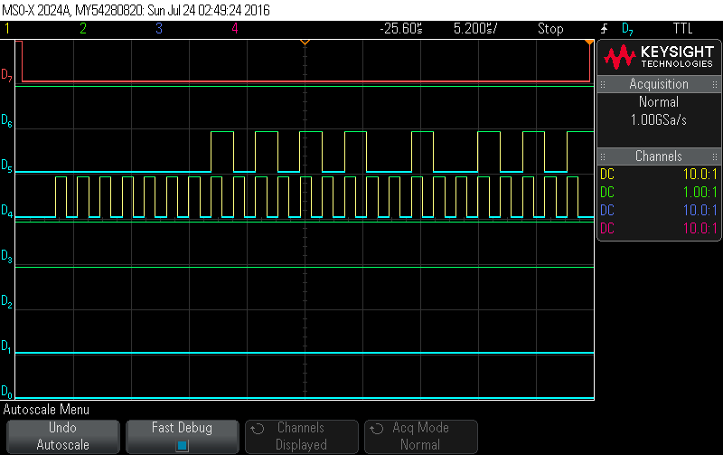

I am working with an F28377S LaunchPad and a DAC7760 over an SPI connection.  My understanding is that the DAC8760 and DACx750 series are very similar in functionality and methodology, so those anyone with experience with those might also be helpful.  I have the USB dongle attachment for the DAC7760, so I captured a waveform that was writing the DAC data register so that I could compare my signal with the one I knew was working.  Below is the capture from the TI dongle to the DAC.
I also captured my own signal from my F28377S to compare.  They appear functionally identical to me.  The only possible difference I can think of is that my signal's MOSI isn't far enough ahead of the rising edge of the clock for the DAC to properly shift in the signal.
Is the rising edge switch on the MOSI possibly an issue here?  How might I adjust it so that the signal does lead the clock?

1.  The DAC uses 24 bits.  8 bits make up the opcode and the next 16 bits make up the data sent.  Optionally there is a 32 bit version with an 8 bit CRC at the end of the burst.  I have disabled the CRC mode via the DAC7760 PC application from TI over the dongle.
2.  The captures are made up of clock (D0/D4), MOSI (D1/D5), MISO (D2/D6) and chip select / latch (D3/D7).
3.  I am verifying that the signal is being programmed through use of the DAC7760 PC application.

Edit:  I have changed the clock phase so that we might set the data high before the clock causes the bits to be latched in.  I have not yet been able to test this because the module seems to be having an issue with communicating with TI's app now.
Edit 2:  See accepted answer for details as to what solved the problem.  In short the issue I suspected was the problem.  Switching clock phase to allow earlier switching fixed the first issue.
  • Going to leave this up in case anyone else comes across the issues that I was encountering, but I have solved the problem. The first problem with the DAC not taking data or responding properly was because of the misalignment in clock against MOSI. By changing my clock phase I was able to shift the waveform from MOSI half a cycle sooner which the DAC accepted.
    The second problem that I was experiencing (mentioned in the edit), had to do with the SM-USB-DIG module. The D4 LED is internally connected to the VDUT signal which provides power for many of the internal modules. No signal was going out because this source was disabled. I'm not sure the conditions for this happening, but to fix it you can activate the CLEAR button in the DAC7760 GUI in the bottom right of the block diagram tab.
