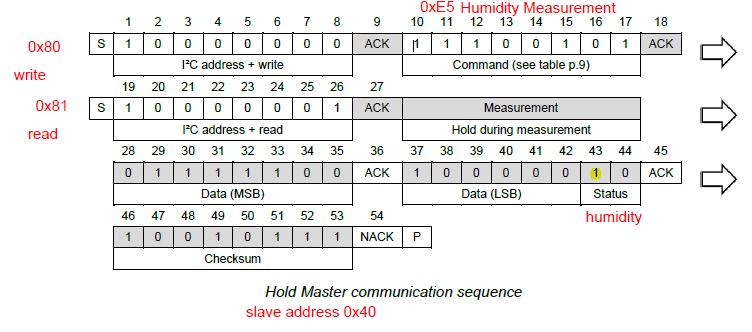

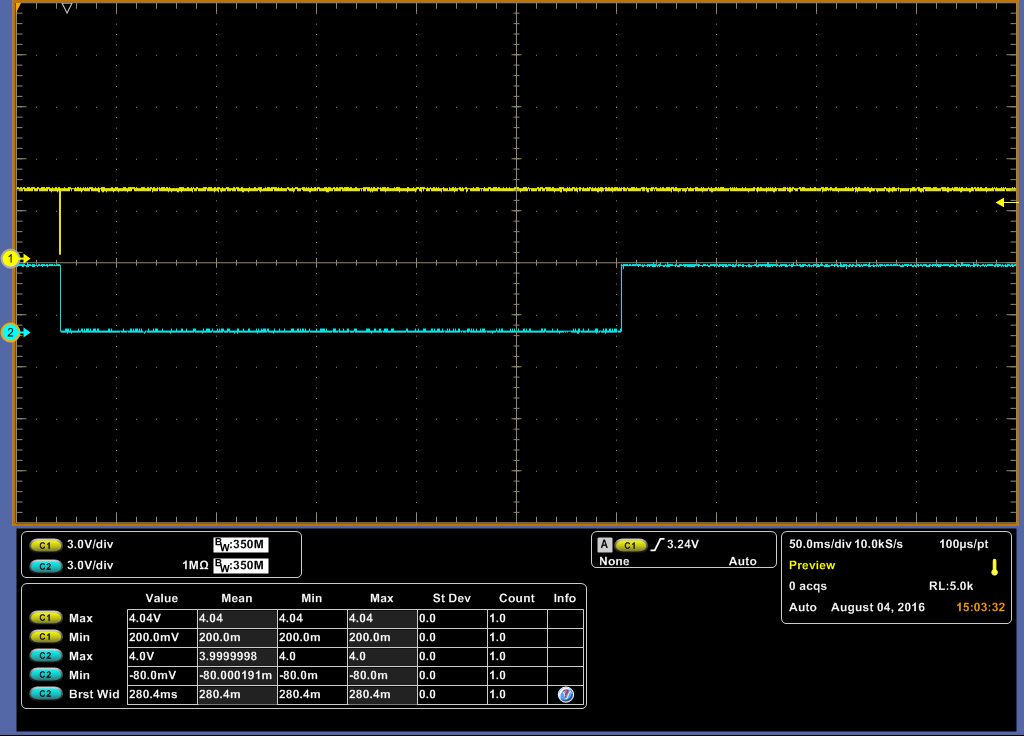

Currently I am using the TI F28335 MCU and try to read sensor data from some sensors via I2C communication, it didn't receive any updated data for all the sensors  I use.
After checking the coding, I found that the process was always frozen at this line
while(I2caRegs.I2CSTR.bit.XRDY == 0); // wait until first byte is out
I2caRegs.I2CDXR = 0xE5 ;
which means the 1st byte was even not sent out
i pasted the code here and appreciated so much if anybody can help me .

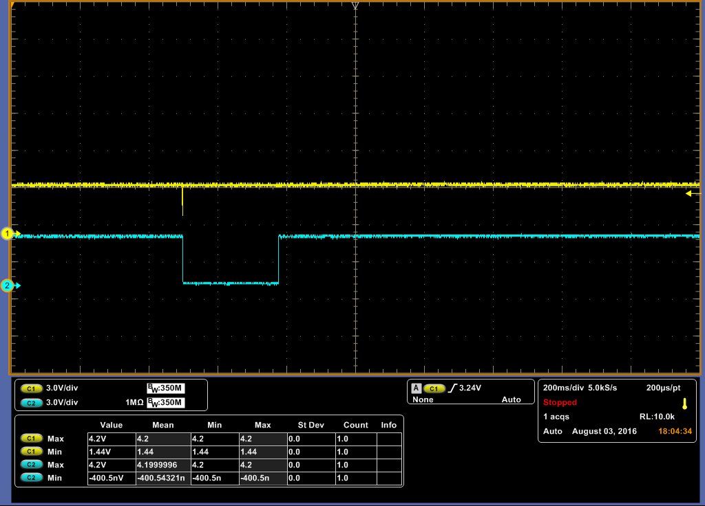

  • hi adam, here is the screencapture i got from the oscilloscope when the code paused at the line
    while(I2caRegs.I2CSTR.bit.SCD == 0); // wait for STOP condition
    The CH1 stands for SCL and CH2 stands for SDA. it seems the MCU keeps waiting for the stop condition :-(.
    Then I changed the while(I2caRegs.I2CSTR.bit.SCD == 0) to while(I2caRegs.I2CSTR.bit.NACK== 0)
    (i know it is wrong, but i just take a try to know what will happen).
    and see the signal in the oscilloscope like this
    The CH1 (SCL) is still always held at low.
    regards,
    alex

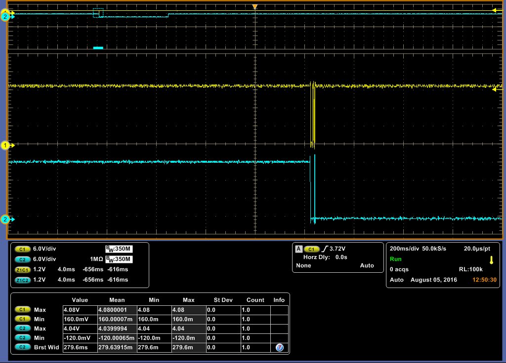

  • Sorry, I meant a screenshot showing the whole transfer, beginning with the start condition.
  • just uploaded two screencapture, pls take a look.
    click the wrong button before when i am not finished writing the post. sorry about that :-(
  • hi Adam,
    And also I attached the I2C communication sequence from the sensor datasheet that I use.
    from the sequence it seems there is only need one 'stop' needed at the end of the whole sequence. So is it means that I need to set the I2caRegs.I2CMDR.all = 0x6620 instead of 0x6E20 ?
    but in the example , they use 0x6E20.
    regards,
    alex

  • hi adam,
    the C file titled with 'adafruit' because the sensor i use is bought from adafruit, which provide the breakout board for the sensor chip . sorry to make you misunderstand.
    As for your suggestion, I modified the coding based on your suggestion, but it doesn't work at all.
    As you said, i write 0x40+write bit '0' and humidity command '0xE5' ,
    I2caRegs.I2CCNT = 1; //
    settingI2caRegs.I2CMDR.all = 0x6420; //NOT sure if this line is correct?
    /* Bit15 = 0; no NACK in receiver mode
    Bit14 = 1; FREE on emulation halt
    Bit13 = 1; STT generate START
    Bit12 = 0; reserved
    Bit11 = 0; STP NO generate STOP
    Bit10 = 1; MST master mode
    Bit9 = 0; TRX master - RECEIVE mode//as you suggested, TRX is 0 for write. but actually the I2C datasheet said 0 means receiver                                                                         //mode. i am confused about this,
    Bit8 = 0; XA 7 bit address mode
    Bit7 = 0; RM nonrepeat mode, I2CCNT determines # of bytes
    Bit6 = 0; DLB no loopback mode ,it should be '0', corrected by alex.J
    Bit5 = 1; IRS I2C module enabled
    Bit4 = 0; STB no start byte mode
    Bit3 = 0; FDF no free data format
    Bit2-0: 0; BC 8 bit per data byte,000 */
    I2caRegs.I2CDXR = Write_humidity_unhold ; /*0xF5 read humidity */
    // while(I2caRegs.I2CSTR.bit.SCD == 0); // wait for STOP condition
    //I2caRegs.I2CSTR.bit.SCD = 1; //clear stop condition flag
  • as for reading, it is 0x40 plus bit of '1' and then read 2 byte of humidity data
    i guess this coding is what you mean

    after I run this, it didn't shows the SCL is at low voltage level and SDA is at high voltage level always.which doesn't work at all.
    appreciated so much again for your help.

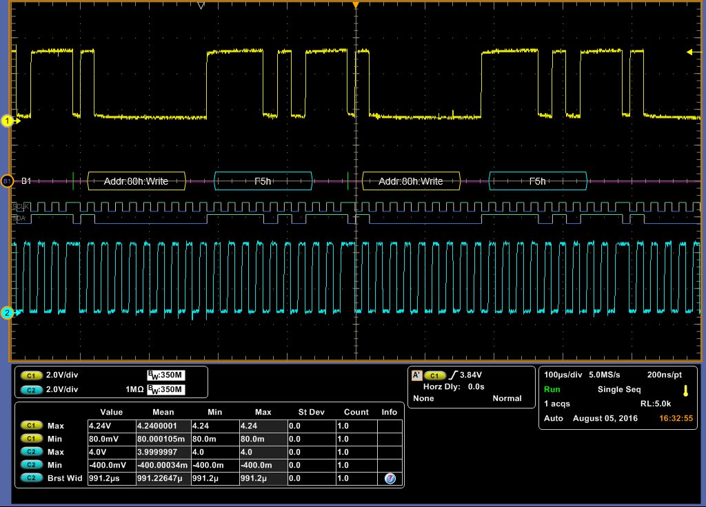

    but unfortunately, the oscilloscope shows the SCL was hold under low level
    and i checked the code found out that the code was still held at this code line
  • Alex,

  • HI Adam,
    thanks for your quick response!
    based on your suggestions, i modified the code again, but this time i got the signal from the oscilloscope like this (yellow line means 'SDA' and blue one means' SCL‘’, the result is similar as the previous screencapture i post.
    and here is the code based on your modification

  • and btw Adam,
    using step by step running mode on code composer, i found out that my code is always stopping at this line
    or this line
    that's why the oscilloscope even can't monitor the address signal. do you know what cause that happen?
    regards,
    alex
  • Alex,
    Please fix the horizontal scale on your oscilloscope capture. It's set to 50 milliseconds/division, but a single 8-bit transfer + ACK only takes 0.18 milliseconds at 50 kHz. The first few transfers might be working, but I can't tell by only looking at a small yellow spike. :-)
    Try 200 microseconds/division and 100 microseconds/division. You can also adjust the horizontal offset (or trigger holdoff, if necessary) to see later activity. I need to see *in detail* what happens between the first start condition and the time SCL gets stuck low.
    -Adam
  • Hi Adam,
    I attached a new one, which should be more clear to see the 'detail' in the yellow spike. i zoomed in that spike area.
    regards,
    alex.
  • Alex,
    We need more than a zoom-in. That "spike" is an I2C transaction -- at least 9 bits, possibly more. Please capture the transaction with a horizontal scale of 100 us/div so I can see the individual bits.
  • hi Adam
    breakthrough; i just modified the code a little bit and now i can observe the slave address signal and 0xF5 signal is wrriten from the oscilloscope. BUT can't read data from the sensor
    you can see that the 1st byte is ended with ACK signal (low voltage level), but the 2nd byte is ended with high voltage level NACK. and it seems the read command is not worked.
    here is the code that I modified based on your suggestion.
    // TITLE:	DSP28335 I2C test
    //          temperature and humidity sensor HTU21D
    //          slave address 0x40
    //          I2C communication structure: send write register address (0x80) + command 0xF5 (for humidity measurement)
    //          and then sent read register address (0x81)

  • Alex,
    It looks like the I2C writes are working. You're skipping the reads because there's no working delay in the while loop. The NACK is expected because you have to wait 16 milliseconds before the next data is ready as stated on page 3 of the datasheet.
    Now that we know the I2C writes are working, I recommend switching back to the hold command (0xE5), which holds SCL low until the next data is ready. If you make a loop with just the writes and use the hold command, you should see an ACK about once every 14 milliseconds.
    To read the temperature in a loop, you would need to do something like this:
    1. Write 0xE5.
    2. Wait for the SCD bit to go high, then clear it.
    3. Start the read. Wait for RRDY to go high.
    4. Read the first byte of the data from I2CDRR.
    5. Wait for RRDY to go high again.
    6. Read the next byte of the data from I2CDRR.
    7. Wait for SCD to go high, then clear it.
    8. Repeat.
    Read page 12 of the datasheet thoroughly. Make sure you understand the expected sequence.
    The example code was written for a TMP100 sensor. Your HTU21D sensor uses a slightly different programming model from the TMP100. The TMP100 takes a register address and lets you talk to that register. The HTU21D takes a command and gives you the result of that command. If you look for pointer addresses in the HTU21D datasheet, you will be very confused! When you change hardware, it's usually not enough just to change a few values. You have to understand what the hardware is doing too. :-) In this case, it's a small difference, but it can still trip you up.
