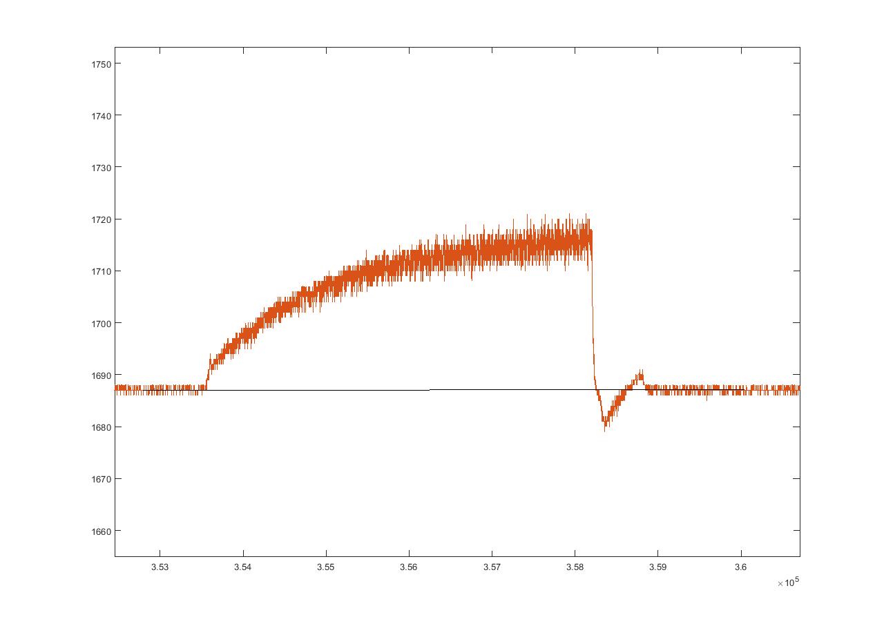

  • Tested with negative Iq_ref value with and without DC bus (Batteries) voltage supply.  Without DC bus voltage, for negative iq_ref and positive rpm, a considerably large voltage could be seen with respect zero Iq_ref.  With DC bus supply, for negative iq_ref and positive rpm, a small current flow into the batteries was seen (didn't test with high speed and large negative number).
    Applied Iq_ref= 2.5 for positive side, rpm was arount 300 rpm, then applied Iq_ref = -1.5 to brake. DC bus current plot was like below,
    Is this a good result ? or is this a something like normal current spike in to the battery?
  • If the regeneration energy of your systems is not high, the test result looks like reasonable. When you put the negative torque for braking, how long motor runs until stop?
    What's the meaning of "Without DC bus voltage"? how can you driving a motor without DC bus source? Can you explain your test setup a little more detail?
