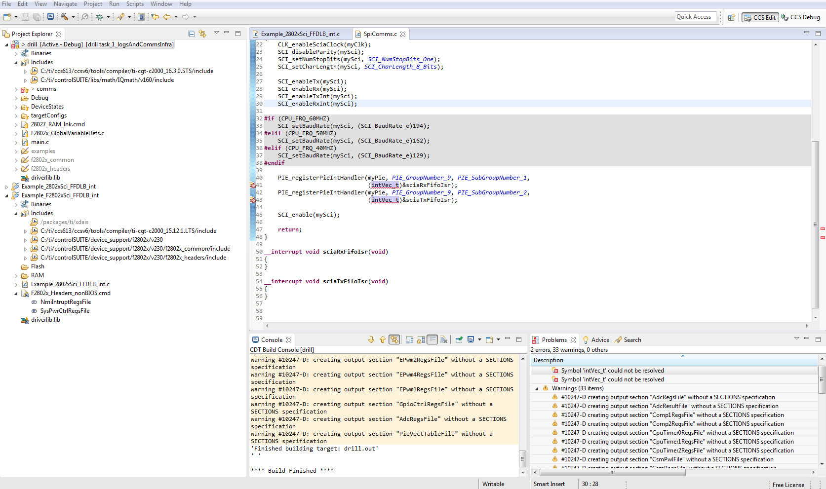

Symbol 'intVec_t' could not be resolved
Other Parts Discussed in Thread: CONTROLSUITE
Hardware: LAUNCHXL-F28027
CCS:  6.1.3.00033 with controlSuite
I'm building from ground up a project in which I need a bidirectional communication with the PC. I'm trying to register interrupts but the symbol intVec_t cannot be found. I know that using an example project would work but I don't want to include everything it has so I created a new project and I'm trying to include files and libraries as I need them. I also tried to find its definition but Ctrl+Click doesn't lead anywhere on CCS and searching with grep on controlSuite folder doesn't yield anything meaningful but only usages of it. How can I solve this missing symbol and where is it located/defined?

    PIE_registerPieIntHandler(myPie, PIE_GroupNumber_9, PIE_SubGroupNumber_1,
                              (intVec_t)&sciaRxFifoIsr);
    PIE_registerPieIntHandler(myPie, PIE_GroupNumber_9, PIE_SubGroupNumber_2,
                              (intVec_t)&sciaTxFifoIsr);

  • I found the typedef for it in f2802x_common\include\pie.h.
    //! \brief Defines the type for an interrupt vector
    typedef interrupt void (*intVec_t)(void);
    Looking at the Includes for your project in the Project Explorer, I suspect you need to add f2802x_headers to your include path in the project's compiler options.
