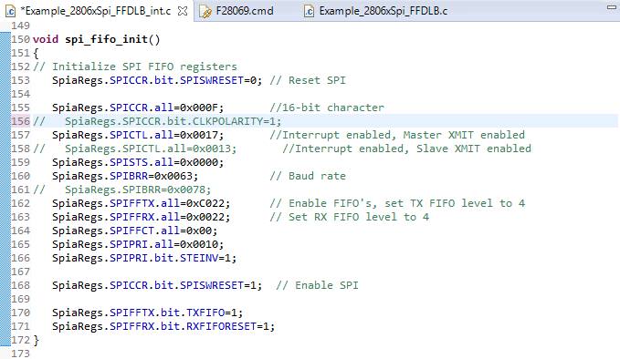

Now I have tried to improve, I have the c2000 microcontrollers F28069M lunchPad.
My desire is to be able to move properly the DRV8711.
I'd like to get help...
Is there any library specifically for my needs or some exempol?
