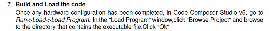

  • Thanks for the reply.
    After continuing reading the FW example and rereading  the TRM I found a table which mentions the
    SARAM specific mode option and the configuration needed.
    I managed successfully to fulfill all the stages of the example guide and to see the variables change,
    besides one stage which results in an error -
    What is the executable file? what does it execute? I have build the project and run the debugger, are
    there more stages needed? Trying to perform these stages results in the error -
    " No source available for "0x3ff75c" "
    From reading the help topic "Program Load and Program Reload" it seems this stage is done
    automatically in this case. So I guess this also should be fixed? or maybe there's a difference between CCS 5 and
    6?
    Amitai
  • Amitai,
    I'm glad you got it up and running!
    The executable file is referring to the ".out" file that is generated from the build step. You are correct though, in pretty much most cases, when you run the debugger, this step is automatically handled. Sometimes the debugger doesn't automatically load the code and then this step would be applicable. I'll append the note to also put clarification on this step.
    Otherwise, if you have the code running, then don't worry about step 7! Happy coding!
