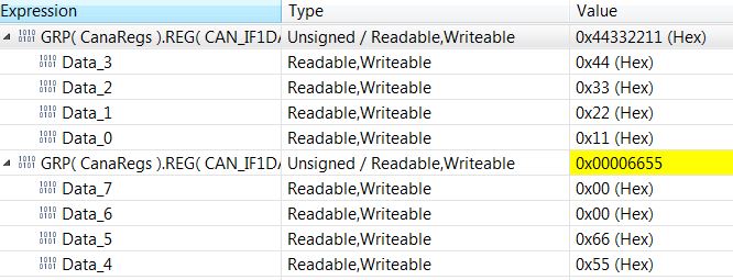

During the debug and test, when I am trying to send a packet of 6 bytes, I found that, in the function CANDataRegWrite() of the driver, where the data is going to be copied to the data register of the CAN, the data is copied in the strange way.
First 8-bit data is copied to 1st and 3rd slot of "IF1 Data A Register",
2nd 8-bit is copied to nowhere
3rd 8-bit is copied to 2nd and 4th slot of "IF1 Data A Register",
4th 8-bit is copied to nowhere
5th 8-bit is copied to 1st and 2nd slot of "IF1 Data B Register",
6th 8-bit is copied to nowhere
it is showing like this when I am using the memory browser and check in the address of the register. Even In the memory browser when I change one of the bytes, it changes it the other one automatically.
Why is it like this? What should I do?
    For each element of the array, despite them being uint16, you should only be putting 8 bits into each element. (ex: txMsgData[0]=0xAA, if you put 0xBBAA, BB will be dropped). Since the C28 core is a 16 bit CPU, you may see duplicates in the memory window due to the complications of CCS reading data that uses the 8bit CAN peripheral bus bridge. I recommend viewing your data using the register window. For 6 bytes of data, you should see something similar to:
