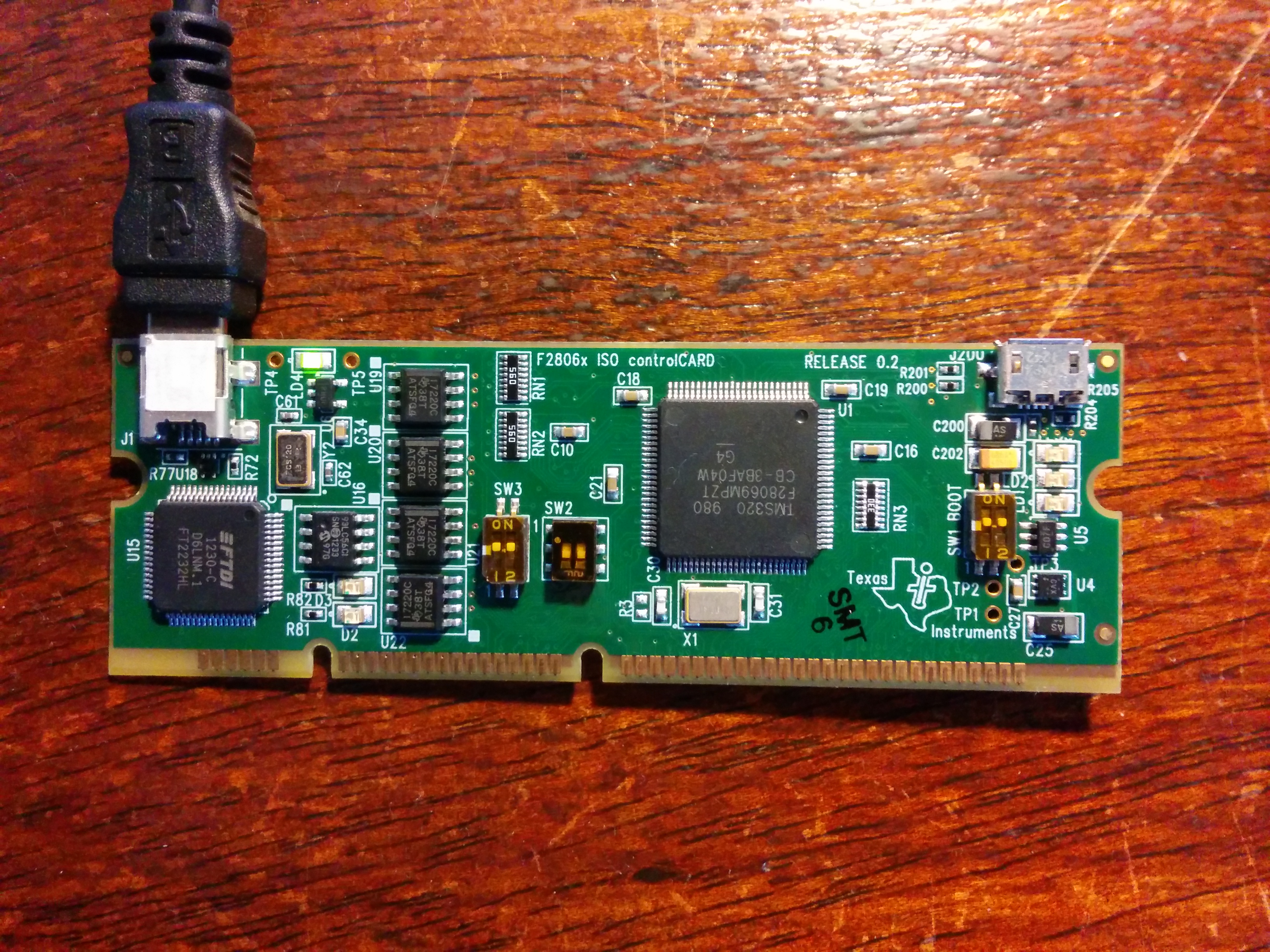

Hi everyone!
First off, I'm new to TI MCUs and am working through the 1-day C2000 MCU workshop.

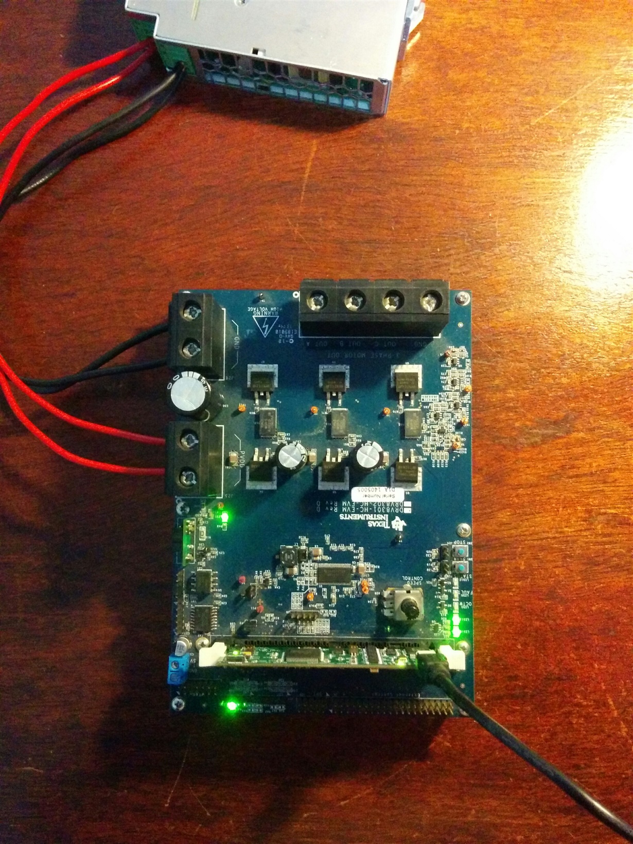

When I attempt to debug the Lab1 exercise to the F28069, I get an error relating to connecting to the target (see images attached).
In my .ccxml file: I'm using the XDS100v2 USB Debug Probe with TMS320F28069.
I'm using an up-to-date v6 of CCS.

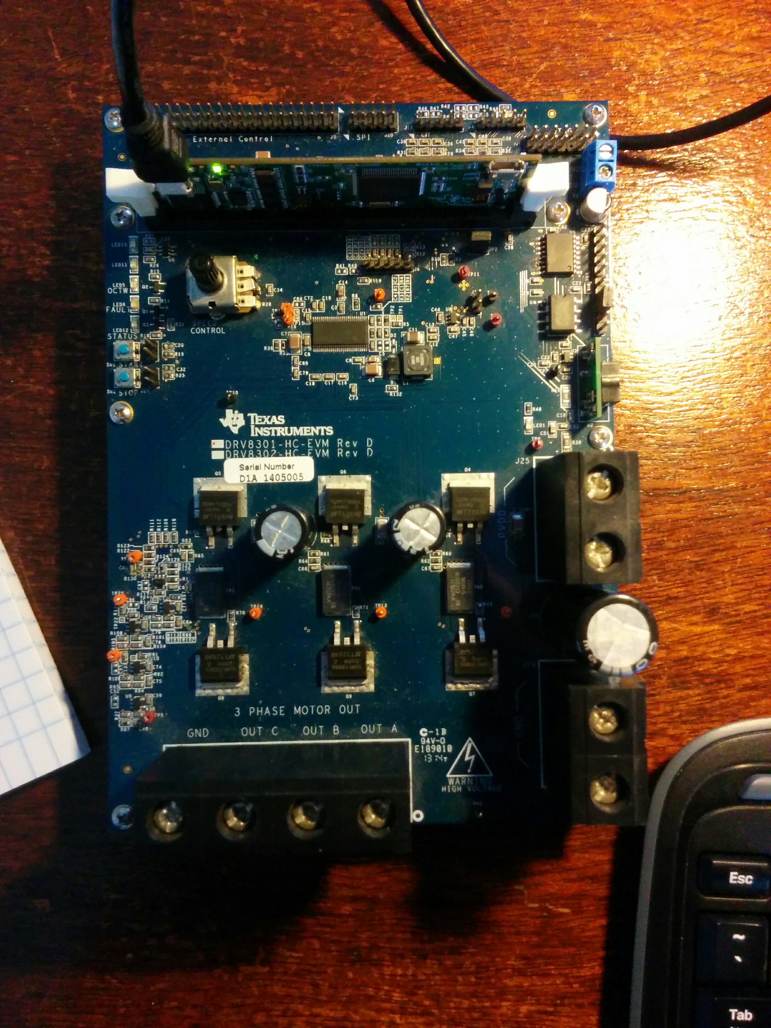

I'm using the Piccolo F28069 with the Three-phase BLDC & PMSM Motor Kit (DRV8301 Rev. D).
Also, as I've seen is customary to do, I've pasted the result of the 'Verify Connection' test below:

Can anyone recommend an angle at which I can attempt to attack this problem?
Thanks in advance!
