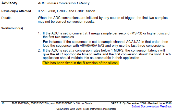

  • Devin,
    Presently i saw one thing in silicon_errata.pdf that,
    The marker line defined, the B revision device (like TMS320F2808) has been fixed. It means the [ACQ_PS] register bit fixed inside ADC module H/W,
    not require to change the bit value in S/W. (ACQ_PS = defult setting for TMS320F2808 board)
    ## Output of op-amp circuit working well and not oscillating.
  • Devin this is not working.
    I'm thinking switch S1 not working properly i.e S1 is in OFF condition.
    As we know that when ADC receives EPWMSOCx request, it can perform multiple conversion automatically, means ADC of switch S1 at that time fully ON of some time period (i.e upto S/H time period) & charge the capacitor Csh. Then the register will produce correct result at [ADCRESULTxx] bit.
    But instead of correct digital value, it produce random value all the time.
    Devin, what should i do?
  • Hi Asim,
    The errata above will only apply if you have silicon before revision B. If so, you can address the issue by increasing the ACQ_PS value and increasing the clock divider such that the sample rate is < 1MSPS. Alternately, you can discard the first couple conversions in each set.
