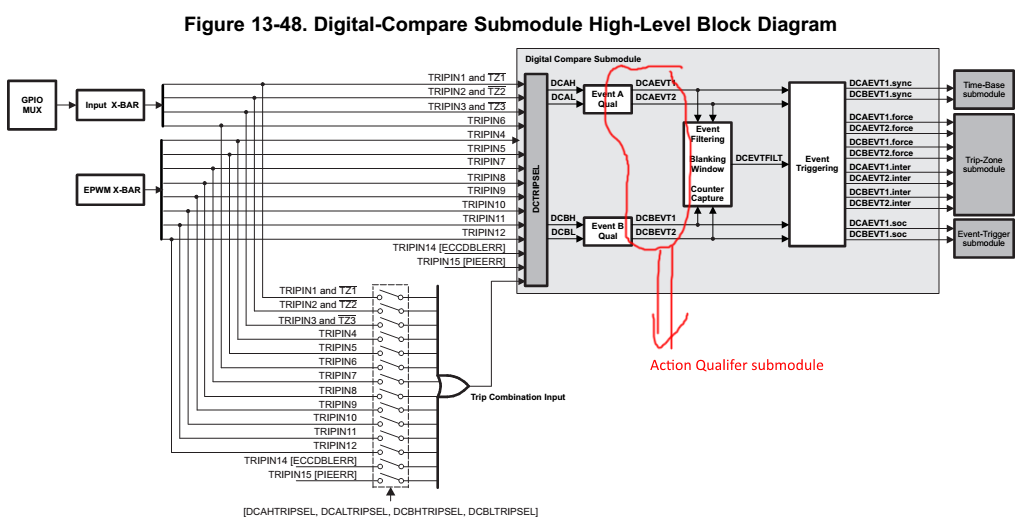

Question2: where is DCAEVTX or DCBEVTX from in the AQTSRCSEL register.
DCAEVT1, DCBEVT1, DCAEVT2 and DCBEVT2 can be selected as source input of Action Qualifer sunmodule.
Take DCAEVT1 for examle,
where is DCAEVT1 from?
Is it DCAEVT1.force in the figure below ?
if so, i think the following Figure should be modified.
    HN: DCAEVT1 signal that can be the source for T1, T2 action qualifier events comes from the output of the EVENT A Qual block.
    I hope this helps.
    Hrishi
  • Thank you for your reply.
    About Q2:
     In your replay, DCAEVT1 signal is from EVENT A Qual block, shown in the following figure.
    Is it correct?
