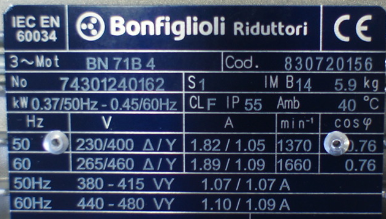

Do you know a way to compute the mandatory parameter from a name plate like the following one?

    I checked the chapter 4.8, but all the industrial motors used by my customers don't have the necessary information on the nameplate in order to compute the required parameters following the chapter 4.8 example.
    Below an other example of a name plate on a Bonfiglioli BN71B4.
    The information are only:
    - Rated voltage
    - Rated current
    - Rated mechanical power
    - Rated speed
    - Rated frequency
    - Rated Cos Phi
    Is it possible to have a rough estimation of motor parameter with that information ?
    Or should I guess with similar name plate information I could use the parameters from a similar motor (identified by InstaSpin on a real motor)...
    Paul
  • no, I don't think you are going to be able to just use the parameters of another motor with similar nameplate. there are many motors that will meet this nameplate but will have very different motor parameters.
    there are ways to figure out enough of the information to do some level of control, but it is not ideal. See this post:
    e2e.ti.com/.../334853
    but motor parameters are critical for sensorless observers (like FAST) to work correctly, so there is no way around this.
    Are you sure the Schneider drive is doing FOC? They may just be doing V/Hz or some other type of control scheme that isn't using an observer. Or they could be getting enough of the basic information like Rs and Ls initially and then using a different type of learning mode to find the magnetizing current. There are certainly drives companies who have much more advanced overall drive commissioning solutions than we do, though we still think purley for a sensorless observer FAST is the best solution on the market.
