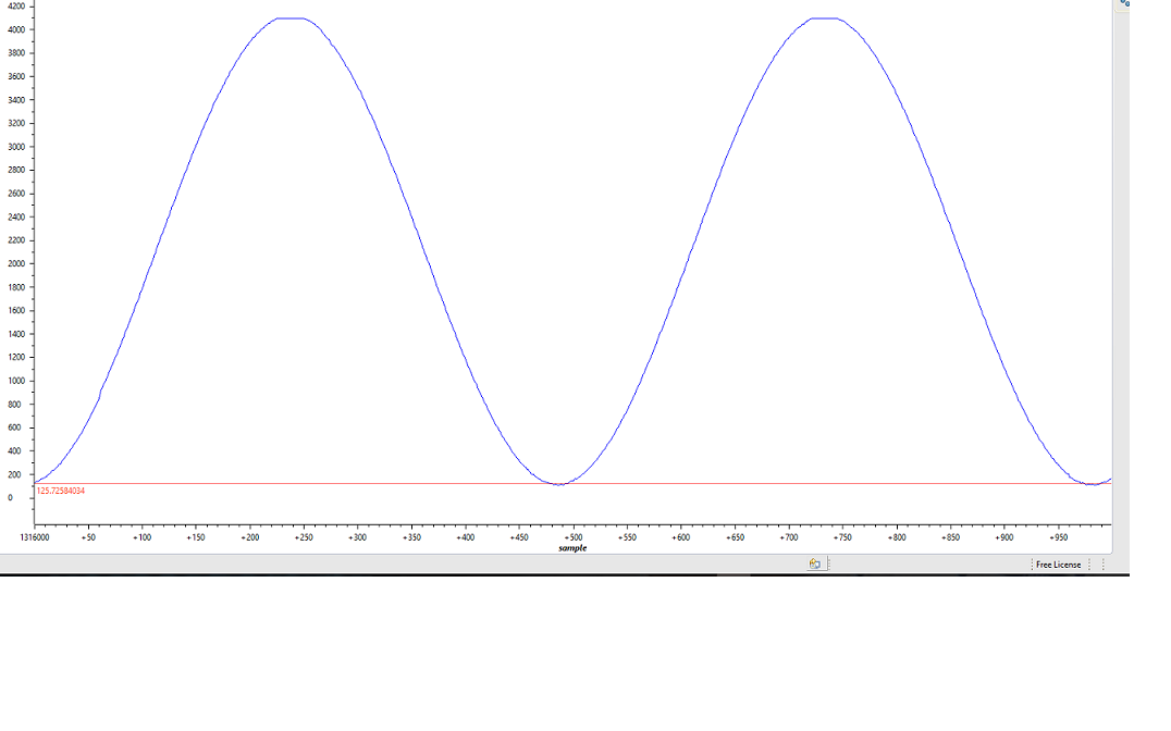

Hi all,
Please I will be glad if anyone can help me trace this problem. I am sampling a 50 Hz Input sinusoidal signal using ADC of TMS320F28379D (Experimenter Kit) and the sampling Frequency is 50kHz. When I graphed the AdcResult, I was expecting to get 1000 samples per period, but I am getting 500 samples per period. Below is the graph from CCS. Also below is the ADC and epwm settings: Thanks in advance for your help.
Note: EALLOW and EDIS were put where necessary.
