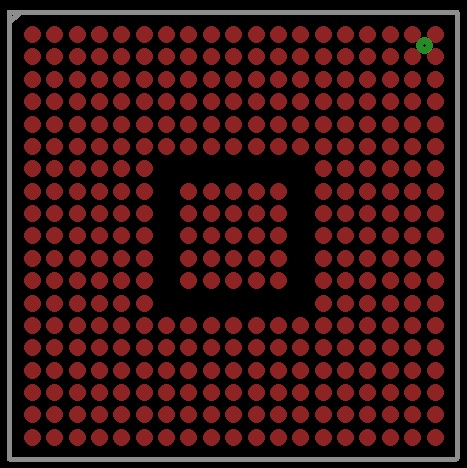

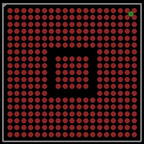

TMS320F28377DZWTS Default footprint
Other Parts Discussed in Thread: TMS320F28377D
I downloaded the footprint of TMS320F28377DZWTS microcontroller from Texas official website and i want to know if is ready for via-in-pad design or I need to resize smd pads?. I have added a 6 mil via between pads to consider the scale.
Thanks in advance,
Fran.

  • are you suggesting that I have to use via-in-pad?
    Fran

  • In previous designs we have already taken into account, and had used a pad of 13,5 mil with a via hole of 6 or 7 mil.
    The problem has been that when I downloaded the footprint of this new microcontroller (from official website) the pads are 21 mil (not 14 as you said), and hence have asked.
    Why this packagin this way? That's wrong?
    Thank you,
    Fran

  • Fran,
    According to page 6 of SPRAA9 document the recommended BGA pad size ranges between 0.35mm and 0.40mm (13.8mils - 15.7mils) for a 0.8mm pitch BGA packages. We are currently reviewing the webbench generated footprint, but based on the above I would go with the 14 mil pad instead of 21 mil pad. Will keep you posted if there are any changes that come out of this review.
    Regarding the vias, using common 5 mil trace/space design rules puts the maximum via pad diameter at 16.5 mils. This will allow you to route one signal trace between two adjacent vias. Depending on the board house process used and corresponding drill tolerance values, the size of the via hole may vary. But based on our own experience a 7.5 mill hole is a good place to start.
    REgards,
    Peter
