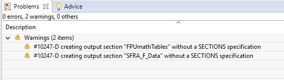

    2) Also, when I debug the main.c I get the following warning (I am not sure if I need to worry about)

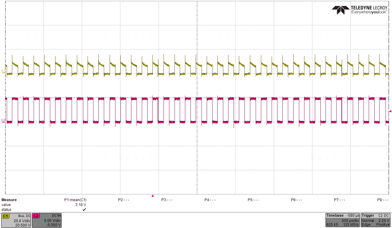

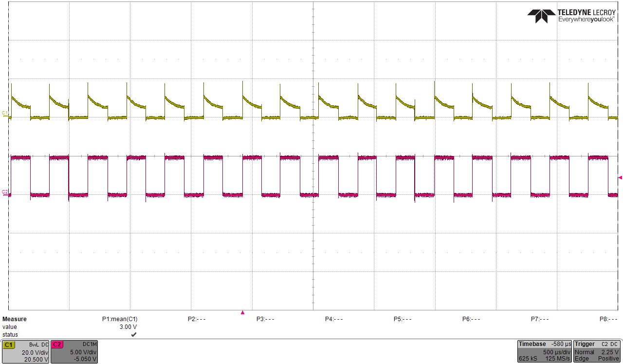

    It also seems like that the switching frequency of the converter is changing: the pink waveform is the duty cycle of the converter, changing as the SFRA sweep moves to different frequencies, for different times. The yellow waveform is the voltage (the one I am trying to use in my SFRA)
