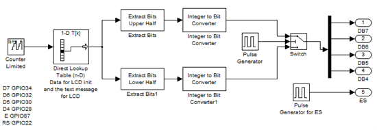

Now, I have no idea how to implement this with the simulink?
I want to make the block in the simulink which I will use when I need to interface with LCD, but have no idea how and where to start?
I was thinking to make interface via SPI interface and connection LCD with 74HC595 ,but first I would like to know how to implement the above code with the simulink.

  • Hi, thanks for the replay and I will analyze it, by the way, I was thinking to crate some simulink model like this one on the picture, then make a subsystem and use it when I want to interface with LCD, but it seems to be complicated to get what I want.
    Ok, now I will try to realize one of your suggestions and go back here.
