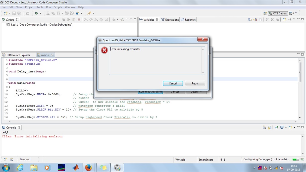

    Now am facing difficulty in debugging it. I am using the XDS510USB Plus Emulator by Spectrum Digital.
    All the resources i referred to said that the drivers for the Emulator was integrated in CCS v5.3. But while debugging, CCS throws an error.

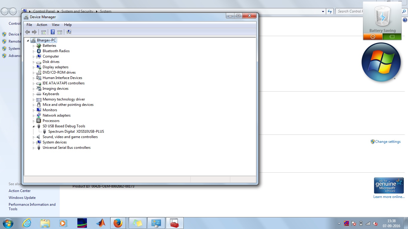

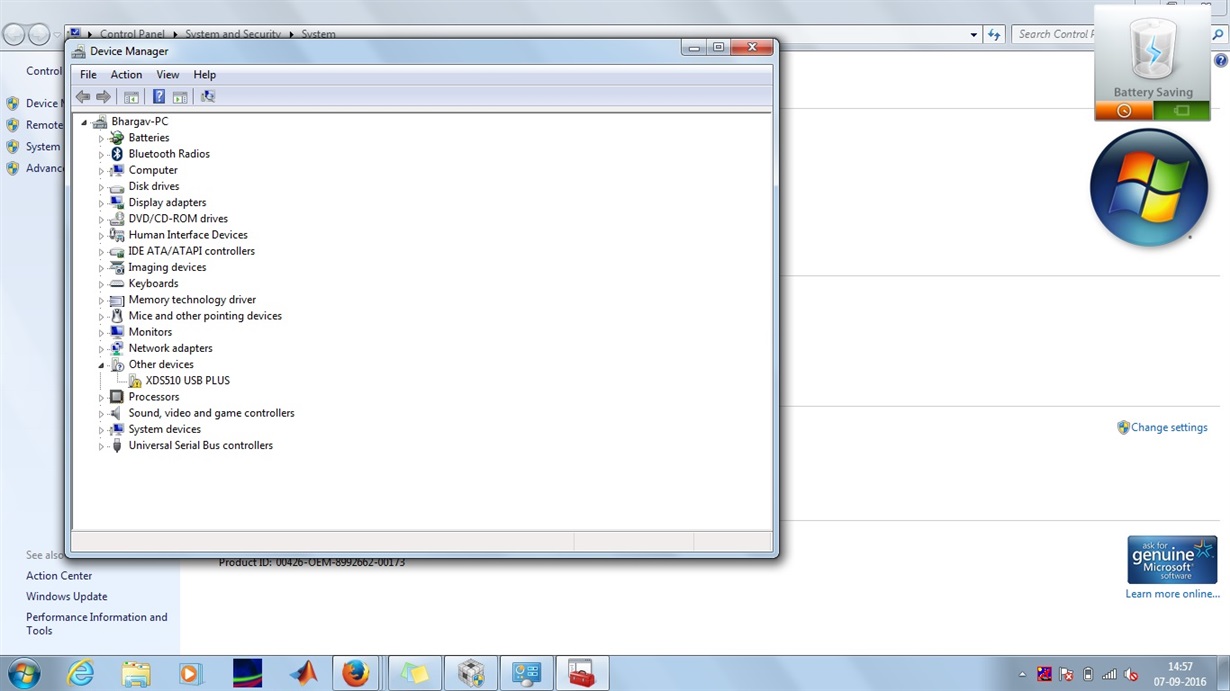

    In the device manager of my laptop, it is being recognized as XDS510USB, but says that the device driver was not found.

  • While installing CCS did you tick on the Spectrum digital drivers? If not, please re-install CCS by including these drivers.

    Yes i have checked the spectrum digital drivers field while installing CCS. Please find attached the images of build settings domain of my project, the error encountered while debugging the project and the device manager dialogue box.
    I am using a windows 7 laptop! Read few other posts in the forum that this might be causing the problem. I tried disabling my firewall and anti-virus, Run CCS in the administrator mode, also checked the compatibility for windows XP SP3 field in properties.
    But no improvements.
    Could you please help me resolve the issue?

  • Hi Gautam :)
    Looks like its working fine now!!
    The JTAG Emulator is being recognized by my system!
    I manually run the application file of the driver that was installed by CCS in this location: C:\Program Files\SpectrumDigital\Emulation\Drivers\amd64
