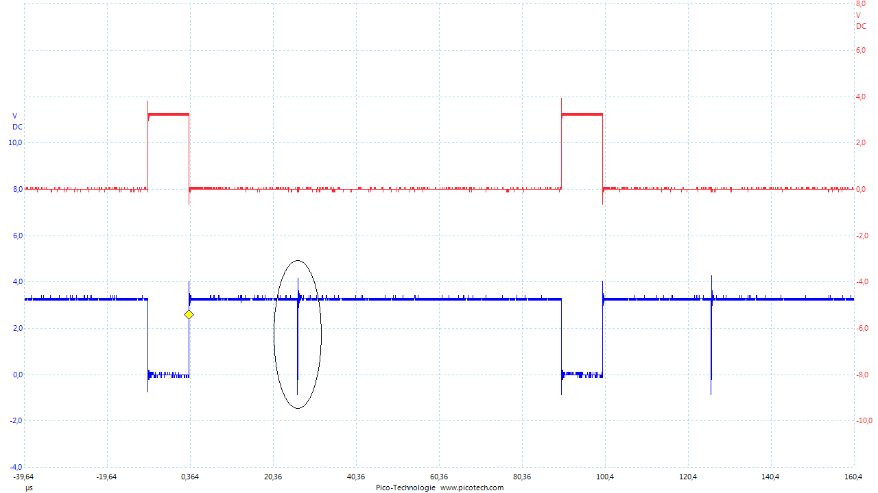

However, the duty cycle signals PWM_AH and PWM_AL show some unwanted spikes. For different values of changingValue I obtained the following measurement results:
changingValue =  -0.4; PWM_AH (blue), PWM_AL (red)
changingValue =  0.0; PWM_AH (blue), PWM_AL (red)
changingValue =  +0.4; PWM_AH (blue), PWM_AL (red)
The corresponding PWM register contents for the last measurement case are provided below:
Contents below the entry CMPAM all have zero value.
I cannot explain the spikes in the waveform that I am measuring. Does anybody have a clue where they might originate from and how to resolve them?

    I can tell you what's happening, but not why. If you look at the TZFLG register it shows 2, which means the PWM1 module has seen a trip event from an input configured in cycle-by-cycle mode. From the TZSEL register, that must have come from either TZ2, TZ3, or TZ6. Possibly these are current inputs on the board. Lastly, the TZCTL setting of 0xA tells the PWMs to shut down LOW when they see one of these inputs. If you look at the scope traces you'll see it's always the high signal which shows the glitch.
    My guess is you're either seeing a momentary over-current event, or a voltage spike coupled from an edge on a different PWM channel which is causing the trip. I'm not very experienced with either MotorWare or the DRV8301 board but I'm pretty sure this is what's going on.
    Can you check the current inputs on the board (IA_FB, IB_FB, IC_FB) to see if there are any spikes there?
    Richard

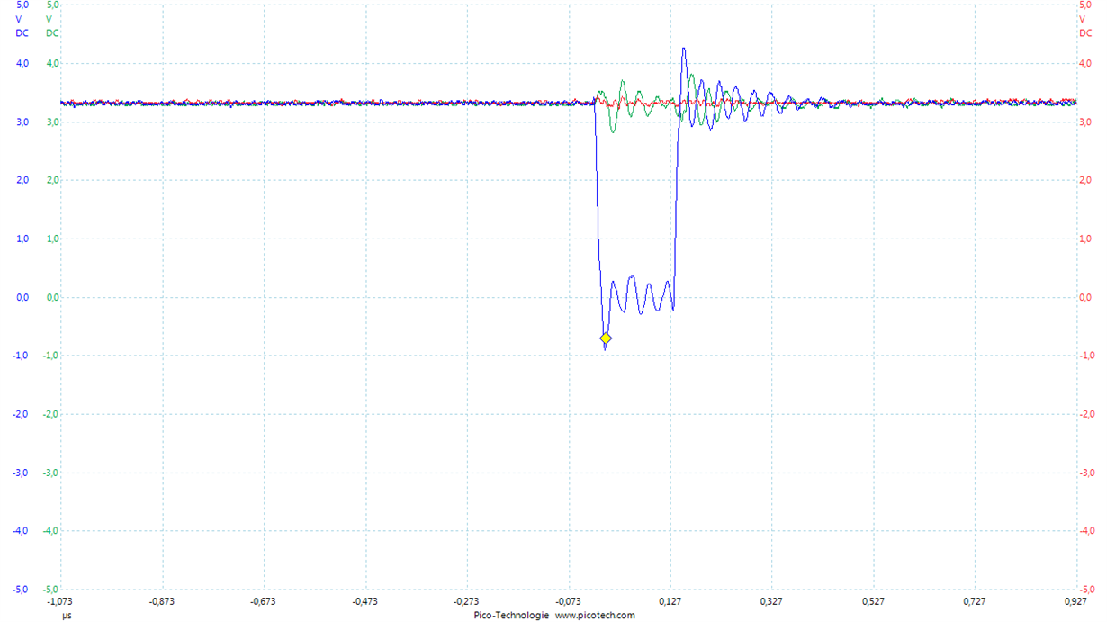

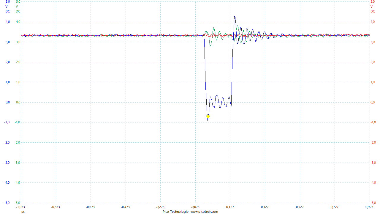

    I repeated the last measurement in the previous post. However, in case of the voltage breakdown the corresponding levels remain high:
    PWM_AH (blue), FAULTn (red), OCTWn (green). Therefore, TZ6 which is the EMUSTOP signal must cause the trouble. Is this plausible?
