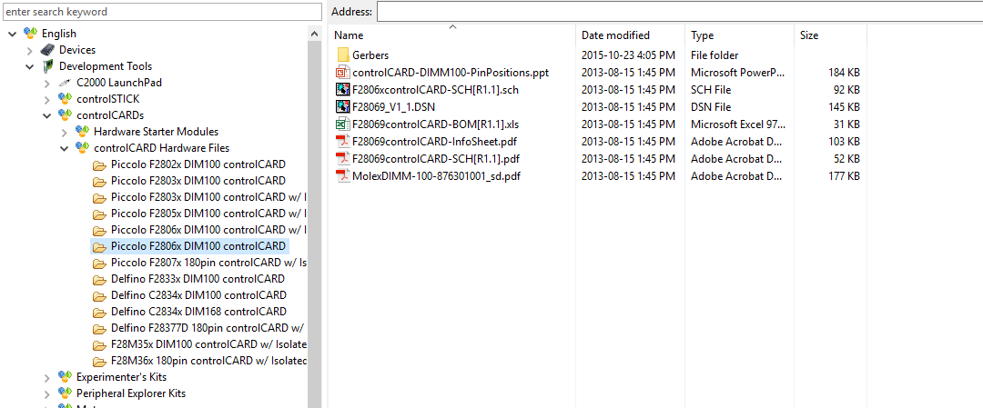

Here I encountered a problem to find the PCB file of f28069 ISO controlcard from controlSuite  or motorware. Since I need to combine the DRV8301-HC-EVM with F28069 controller circuit into one board, and I need the package of most component on f28069 ISO controlcard.
It's strange that I only see the .sch file in the fold C:\ti\controlSUITE\development_kits\~controlCARDs\CC2806xHWdevPkg\R1_1
Appreciated a lot if you can give me some insight on this problem, and greatly than ks if you can send an pcb file to my email eric@esit.com.

    There are three versions of F2806x controlCARD - two have an isolated emulator on board (TMDSCNCD28069ISO, TMDSCNCD28069MISO) and one the assumes emulation comes from the baseboard (TMDSCNCD28069).
    We try to keep up to date with Resource Explorer, but occasionally things are not put in.  It looks like the ISO collateral is not included.
    The ISO controlCARD's collateral can be found at the below:
    \controlSUITE\development_kits\~controlCARDs\TMDSCNCD28069ISO_v1_1\
    Good luck in your project!
